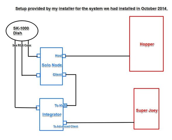

So here's my situation:
I have a Dish TurboHD satellite connected to a Solo Node. From there, the "host" line goes to my living room and connects to the Hopper DVR.
The "client" line goes to a Holland 3-way splitter. One line off the splitter goes to my Hopper Internet Connector, which plugs into the router via ethernet. The remaining 2 lines go to 2 Joeys in other rooms of the house.
I want to add a third Joey, which I know the system will support. If I choose to add a wired one, I believe that all I will need is a 4-way Holland 2150MHz splitter. However, I am not completely sure that I will be able to drill through the top plate of the wall where the TV will be mounted on (110V is already there), since the roof pitch leaves me almost no space to work.
That leaves me with the option of installing a "wireless Joey." What equipment would I need to add the WJ and appropriate wireless connection, and what would the schematic look like?
Attached is my current setup.

You would need to get a Wireless Joey Access Point and the Wireless Joey. I have my Access Point plugged directly into the Hopper via Ethernet cable, which provides a dedicated wireless signal to up to three Wireless Joeys. Looks like if you have a HIC in your system (I don't), then you plug the Access Point into that, or perhaps you have the option of plugging it into either one.

Thanks. One more question, in the name of future proofing:
Let's say that down the line I wanted to add a Super Joey to get more tuners. Is it simply a matter of connecting the third LNB with the unused wire to the integrator, similar to this diagram? I can't get pictures of the dish or wiring until this weekend.
