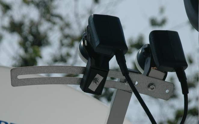

While the attachment below is out of date (bracket has been switched around in anticipation of the addition of the AMC4 LNB) it does show my setup. The left LNB is pointed at AMC3, the right at IA5. Originally, the dish was pointed at IA5. With AMC3 10 degrees away, I moved the dish approximately 4 degrees towards AMC3 (not changing the dish elevation) and offset the IA5 LNB (was some signal loss on IA5, but was a major boost in signal quality on AMC3).
