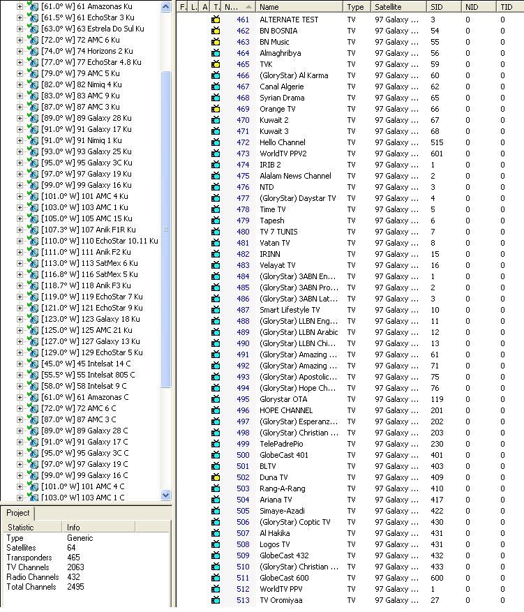

Also - being a pain in the butt again, please list the satellites by degrees... like 030 Hispasat, 043 Intelsat 3r, 103 AMC 1, etc. so that when you sort by satellite it ends up ordering them along the way they are lined up on the arc so that the motor is not moving all over the place between channel flips.

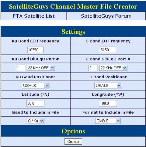

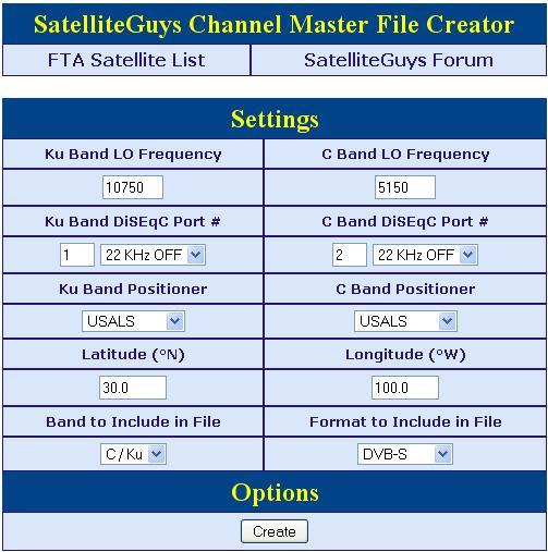

Here is an example using the default settings (You can change the settings in Channel Master):
The output is a zipped cmproj file.
I have tested it on my Pansat 3500 and Coolsat 6000.
