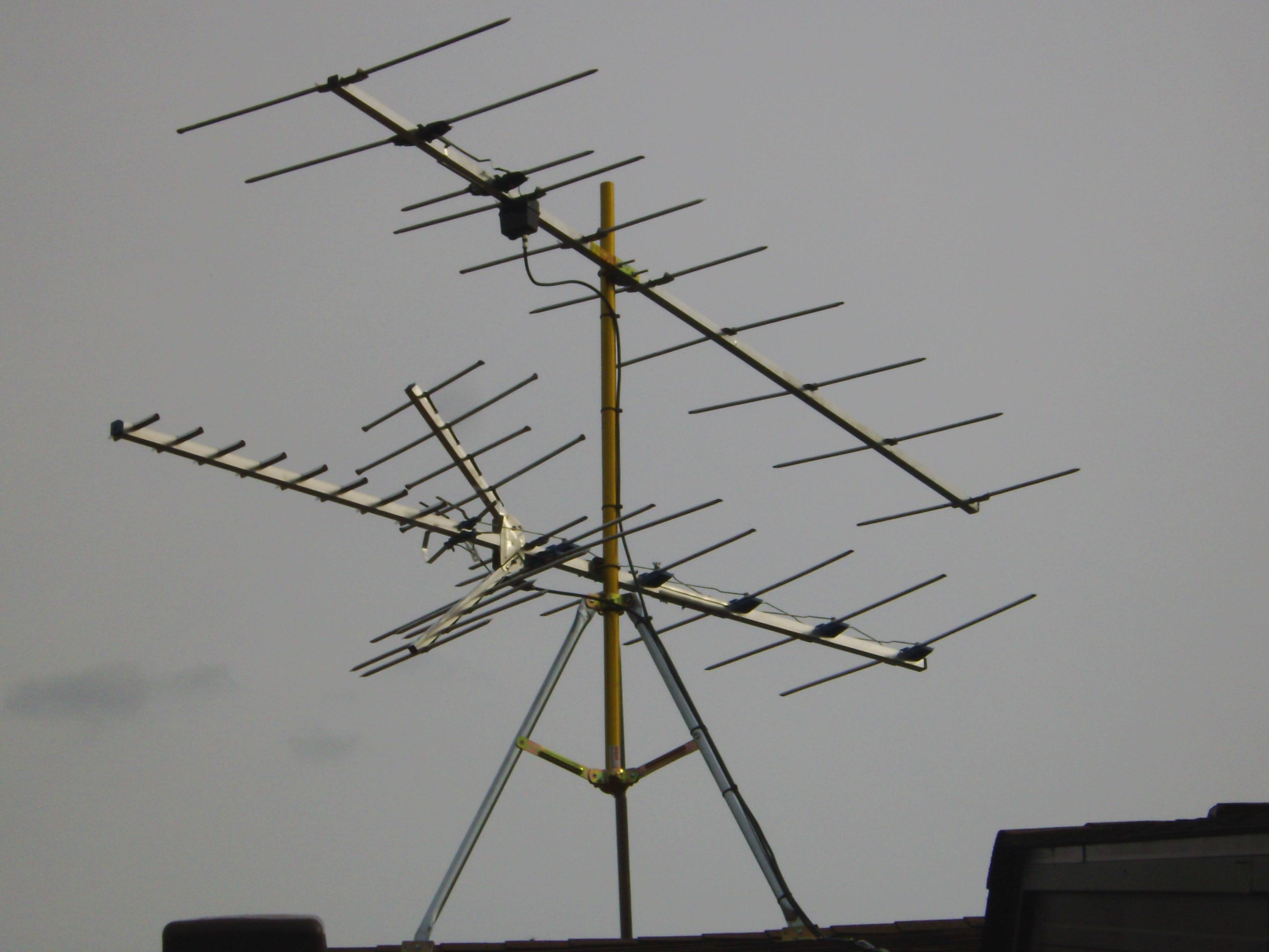

you should be good then if you swap out the antenna for 2 separate ones especially to get Lincoln
since one antenna is VHF only and one is UHF they can be mounted close to each other. I have a VHF only and a combo unit mounted about 2 feet from each other
