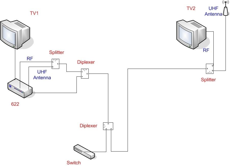

I use a splitter to combine the TV2 output and the UHF remote, then diplex it to TV2. At TV2 I use another diplexer and a splitter, one output goes to TV2 and one to the antenna. So the antenna is at TV2. This is on my 625 but it should work the same way for the 622.

Just for visual, this is how it would look:

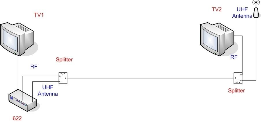

I'm afraid I don't quite get the diagram. I'm not sure if I'm dense, or what.
Sorry, I don't have a pretty diagram but that's the way life goes....

I don't see how I'm going to insert the Antenna in there. Unless I do it like this:
Code:
UHF Antenna-->                                 <-- Antenna In
                          Splitter <--->Splitter
 RF Cable -->                                      <-- RF Out

That's the way to do it in your setup. Just use a couple of splitter and you're set to go.
Or using the pretty diagram:

Thanks. I had it right then with my ugly ascii Diagram then. I was concerned with the fact that the splitter was working asymettrically. I hadn't considered that as a possibility.
I'll assemble the parts and make my wife happy soon ;)

I didn't need the diplexors. I just used the UHF antenna ($5 at Lowe's) and a pair of RF splitters ($4 at Lowe's).
I can hide the antenna behind the TV and it's still strong enough to receive the signal from the remote. I have RG-6 and termination tools floating around so there was no problem getting the cables built.
Works like a charm, and my wife will be quite happy with the results when she gets home :)
