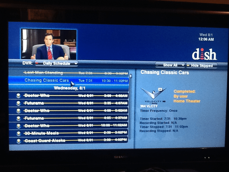

Hmmm... So PTAT is locked to tuner 3, I can set timers, but they apparently don't work. See the attachment.
Timer start and stop times are shown, but record start and stop are N/A.

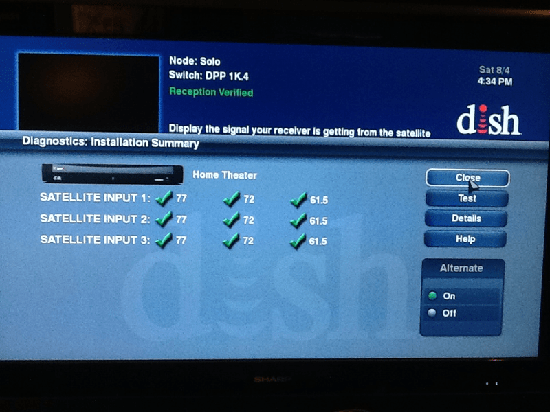

That was quick!
Tech came out, just beating the storms, hooked up a Solo Node at the dish, and now I've finally got all I paid for! He wasn't here 15 minutes.
So PTAT should work tonight. Interestingly, it did work Thursday night. I think because the Hopper was off when the time came around, so it could use whatever tuner it liked. Friday, it didn't work, but I was home and watching TV when the time came.
Hopefully, I'll be in full Hopper bliss now!
Thanks for all the follow-up, and thanks to DIRT for their support!
