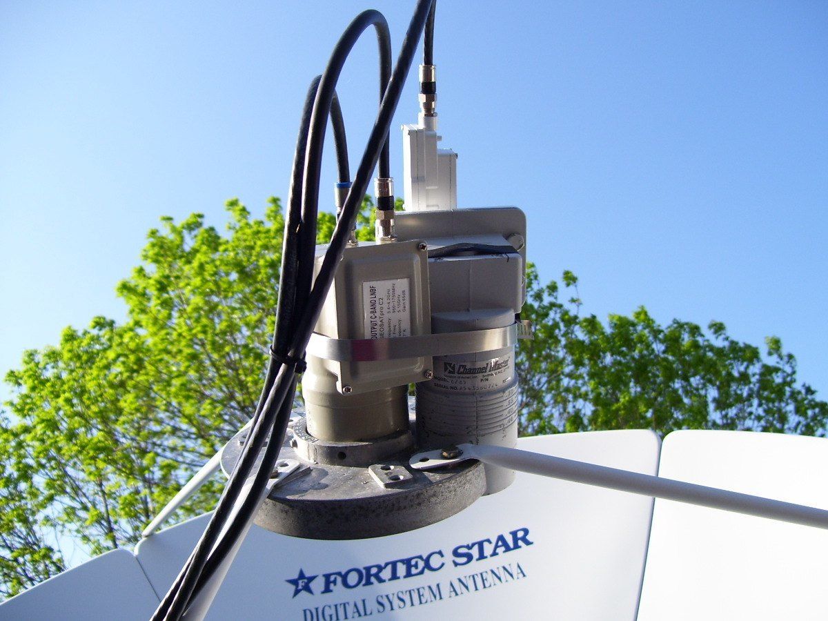

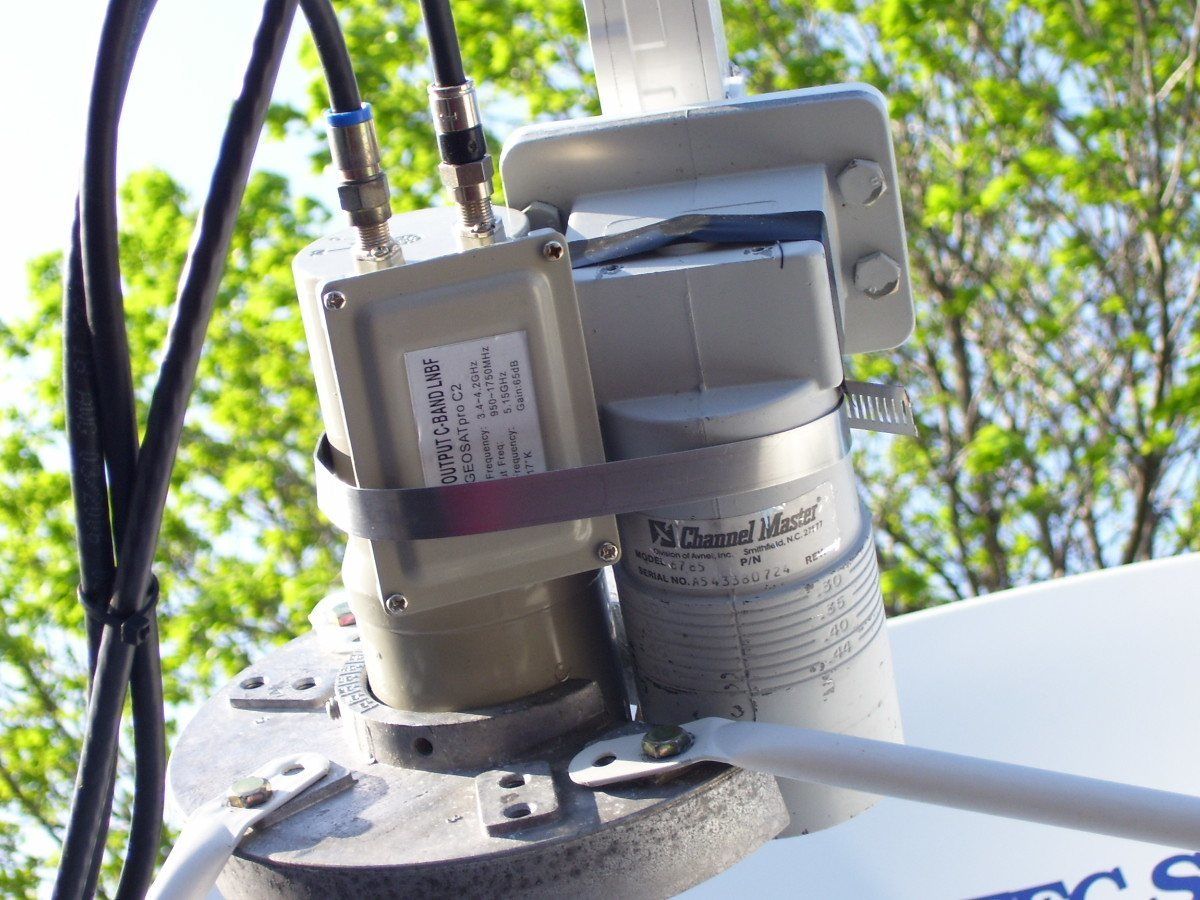

addition...here is an old setup I had
The left LNB was at 99W and is voltage controlled so it got both polarities.
The right one (Channel Master) is an old LNB that got one polarity. The polorotor (blue box) broke off so the electrical tape is to keep the notch (polarity notch) from moving. It was aimed at 103W and got the Horizontal ONLY stuff.
I stuck a screwdriver down the throat of that LNB to skew it to optimize signal
