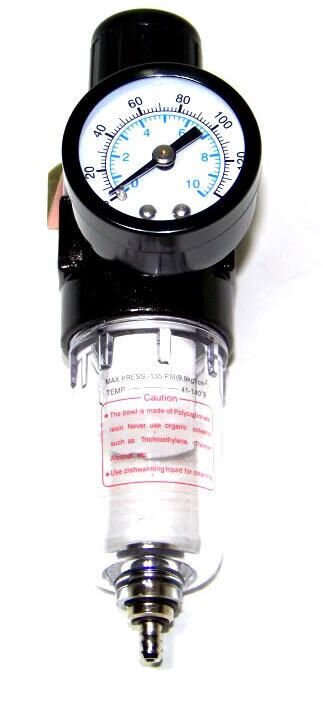

Fans do bring in a lot of dust. Do not mount electronic equip. in a closed stand. I am 1 of those people that blows out the dust with my air compressor. Never caused any problems. The amount of dust that comes out of a PC is unreal.
I'm one of those people that never use a ground strap when working on computers. I think they are a myth. 10+ years of working in computers and never had a problem. I actually like using a vacuum on my computer, compressed air is full of moisture and can knock parts off the motherboard.
adjust the air compressor psi output, maybe 10 to 15 psi is enough to work with electronic equipment and be sure to include a regulator with a water trap
