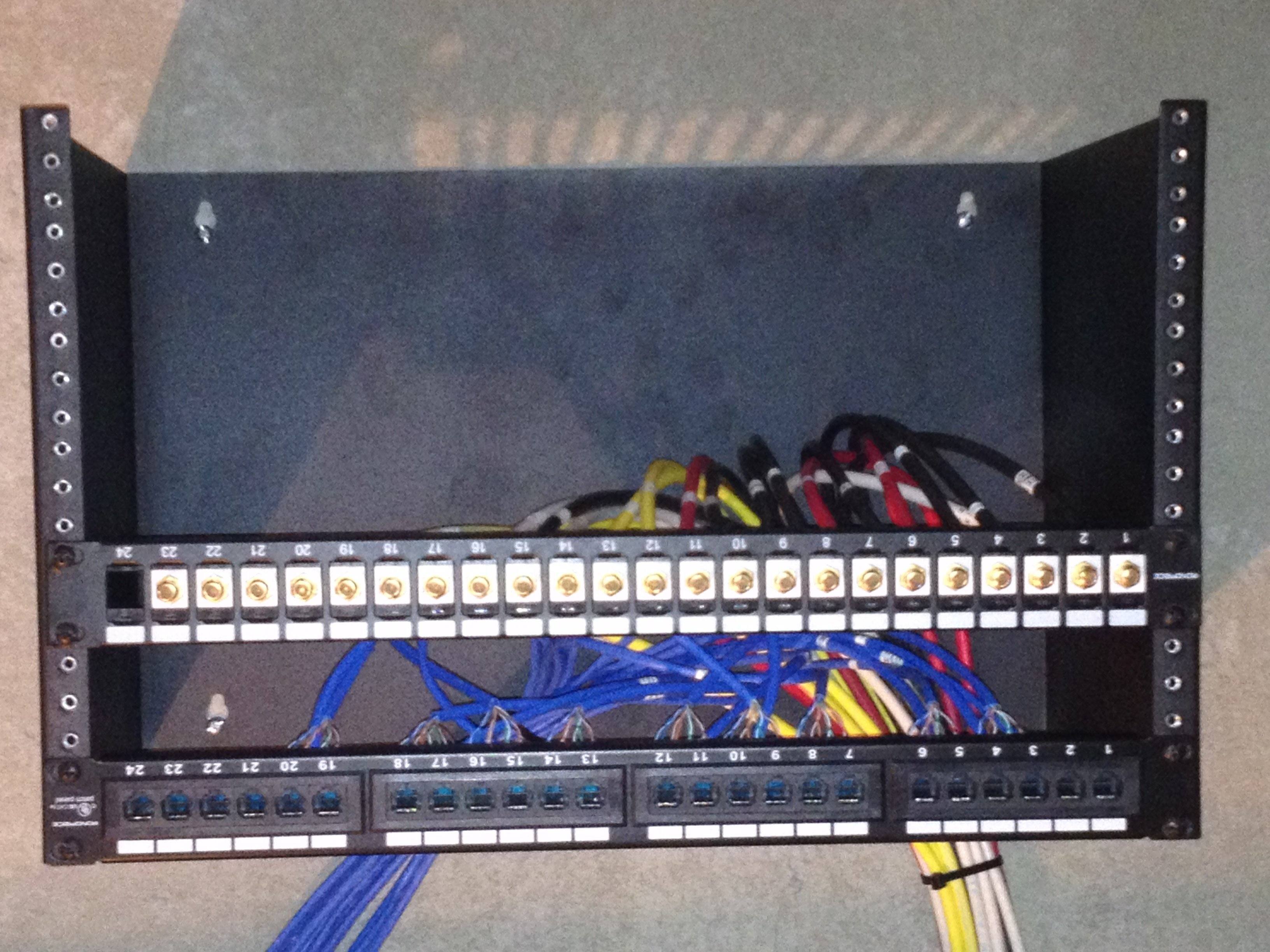

You mean something like this?
My installer had no problems with it. I had ran all the lines and terminated them when we built the house this year. I also had a string between the basement and the attic in a wall so all he had to do was pull his wires up to the attic, out the soffit, and up to the dish. Only thing extra he did was to change out the F barrels where he was putting the hoppers and joey and in the patch panel since he didn't think they were rated at 3 GHz. He was right so I am changing out all of them.

About 12 years ago I had my house built with a centralized distribution panel with "home run" drops using Panduit products.
There are two wall jacks on opposite walls in every "livable" room and the garage. Each wall jack has two RJ45 jacks with Belden 1872A Cat6e MediaTwist cable and two 3GHz Belden
1694A RG6 coax terminated in each. Except for the media room which adds a third RG6 termination as well as blank space for future expansion (fiber optics). It's all terminated in patch panels mounted into a wall mounted rack much like the photo in the previous post.
When I had it installed neighbors thought it was excessive. Especially home-run everything. So far it has been future proof with maximum flexibility. Never regretted a red cent spent for it. For an installer it's a dream - took him 2 hours from dish mount to joeys.
