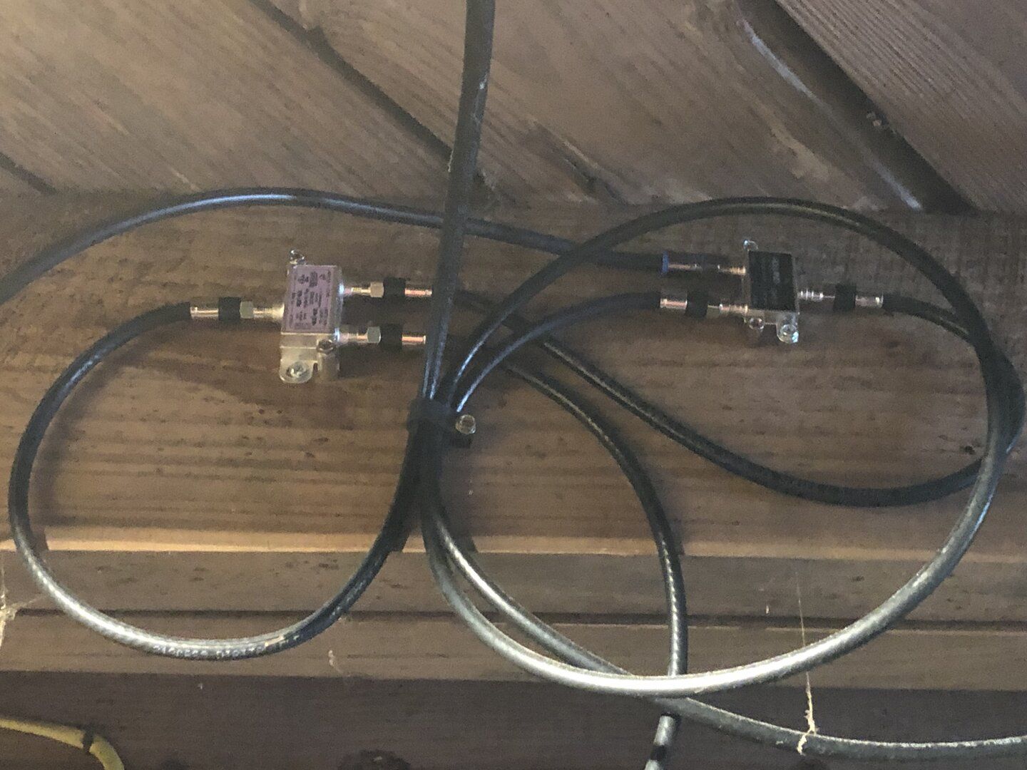

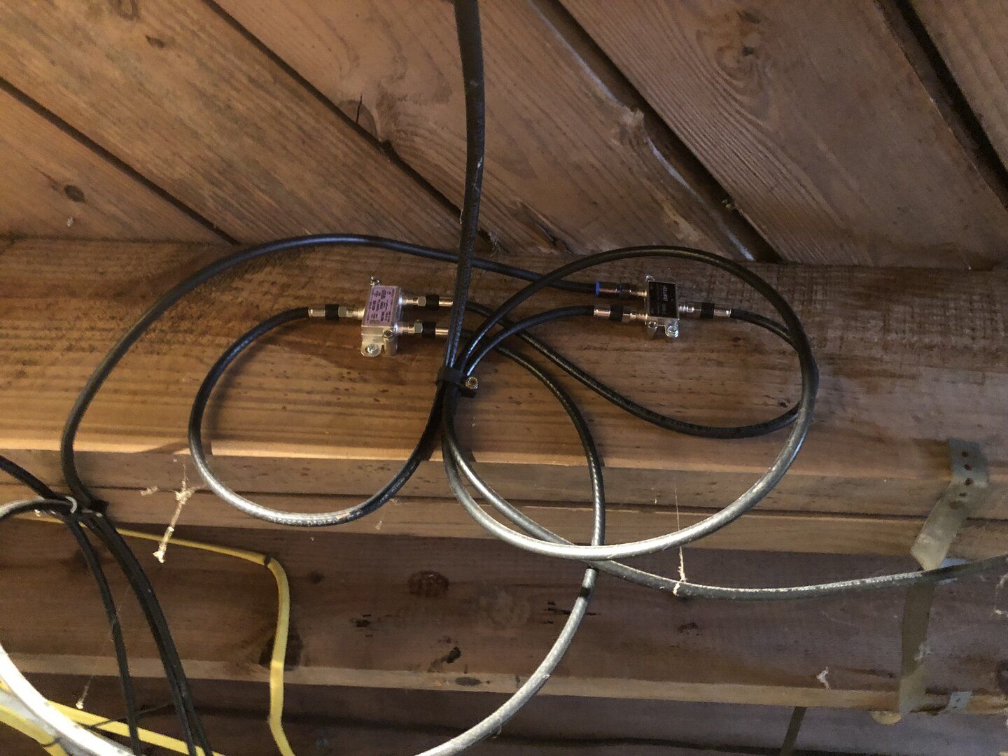

Hi gang,
I've got an H3 and two wired joeys. I just got broadband to my lake house so I'm dropping the joeys from my account for streaming sticks. I need to know what I can remove from my current wiring setup without disrupting the Hopper. I've attached photos that show splitter and diplexer. I'm keeping my H3 and want to use the existing Joey RG6 to connect my antenna to local (distant antenna) channels.
The main reasons I want to do this is lip sync. Local channels don't sync when watched via Dish Anywhere even though on the hopper it's fine. I'm using the OTA dongle for locals so I can easily split that to my former Joey sets. Any advice would be appreciated. Thanks...

It looks like you have a Hybrid Tap (the purple one on the left in the picture). Take that out, and use a barrel connector to connect the cable that was coming into the Tap (to ODU) with the cable that was connected to the Host port (to Hopper). Remove the cable that was connecting the Client port on the Tap to the input of the splitter. Your antenna can then be connected to that input, to feed your Joey locations.

I guess after looking at this wiring more, I'm wondering if I can completely removed any diplexer and splitter and just barrel connect the dish feed to my Hopper? That frees up my RG6 to the two former Joey rooms where I can hardwire the OTA antenna. I'm assuming the Hopper is OK with that? Straight connect from LNB feed?
We have a WINNER! Sorry I didn't read your response closer. Works exactly as you described. Thanks bro...

Great! Cheers mate. Good info. Both my accounts have an H3. I removed the diplexer and used a barrel connector to bypass everything. No probs at all. Repurposed the splitter onto my OTA antenna for the other 2 locations and works perfect. No hiccups on the H3 and no lip sync BS on my secondary locations but have to use the "TV" input there. .
Dishanywhere has lip sync probs streaming local channels. Wasn't a problem when I had locals through Dish via Joey so not sure what's up with that. No biggie though because direct connect on "TV" input solved it. Works fine on the primary display connected directly from H3 to TV though. One of those weird anomalies.
Use a good barrel connector(3 Ghz, blue center) in the Hopper satellite line. Stay away from the cheap clear center barrels.
