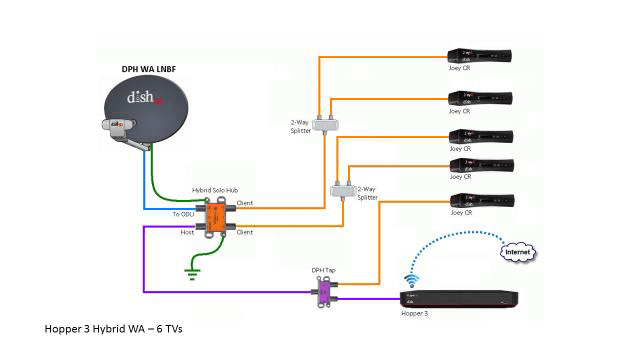

dvrexpander SatelliteGuys Master Aug 23, 2009 5,030 322 Near a tree Feb 4, 2016 #21 I used to do two splitters for joeys when installing them - nothing wrong so long as the rest of the line is fine and there weren't some low pass barrels in the lines. Let the installer do his job - they know what they are doing.
bobvick Pub Member / Supporter Pub Member / Supporter Lifetime Supporter Jul 20, 2006 4,464 2,163 Northwest Alabama Feb 4, 2016 #22 dvrexpander said: they know what they are doing. Click to expand... You hope... I have had a couple that were dumb as bricks, and I had to fix their mess. One of the reasons that I just prefer to do my own work. Reactions: WiCkeDuDe
dishcomm SatelliteGuys Master Nov 29, 2005 10,388 554 suburbia Feb 9, 2016 #23 JSheridan said: This is direct from the Hybrid wiring thread: View attachment 113598 Click to expand... Those are hi frequency (5-2000 hz), yes?
JSheridan SatelliteGuys Master Lifetime Supporter Feb 16, 2008 8,899 10,028 USA Feb 9, 2016 #24 dishcomm said: Those are hi frequency (5-2000 hz), yes? Click to expand... I don't have one handy, but they're the official DISH Hybrid Taps.
