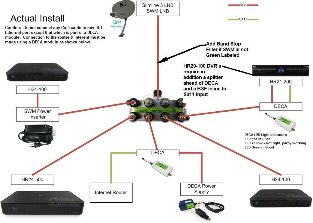

Thanks for the replies guys! I actually already have an 18" dish on the guest house with 2 cables coming into the house for one receiver. The installation of an HD dish and new receiver will be upgrades along with a tv. Still old school at the guest house. I have noticed that some of the dish's sold include a power inserter and 4 or 8 way splitter. Is this a most recent dish with single feed to lnb? I have seen others sold with a 4 input lnb too. A little confused as I am not up on the latest technology.
The single wire SWM setup is the latest and is becoming the normal install. The old one works fine, but not with the HR34 or H25.
Is the latest SWM compatible with the older receivers? Would I have to use both Sat. inputs on the receiver? Thanks!
The SWM set up is compatible back to the HR20's.
If you do go with the SWM, then you only use the one input labeled SWM and make sure to run the Repeat Sat Set Up so you can make sure the new equipment is recognized.
Like this:
HR20-100 has some additional hoops to jump through.
