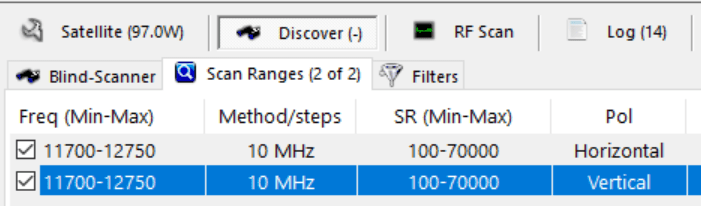

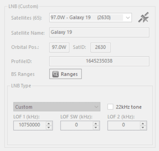

I used my Edision to point the dish at 97w and confirmed many transponders. Then hooked it up to the 5520SE, confirmed the dish hadn't moved, and ran a blind scan. It's stalling out on the blind scan... going 15-20 minutes with nothing. Do my settings look right? I'm using a standard 10750 LO Ku LNB
Update: let it run for an hour, still nothing
Yep, I have never got the 5520 to blind scan correctly. I can put my transponer.ini file for DVB Viewer on dropbox, you can download it and put it in Viewer, then manual scan. Ooops never mind. I am C-band only with a fixed dish on 103w for Ku.
