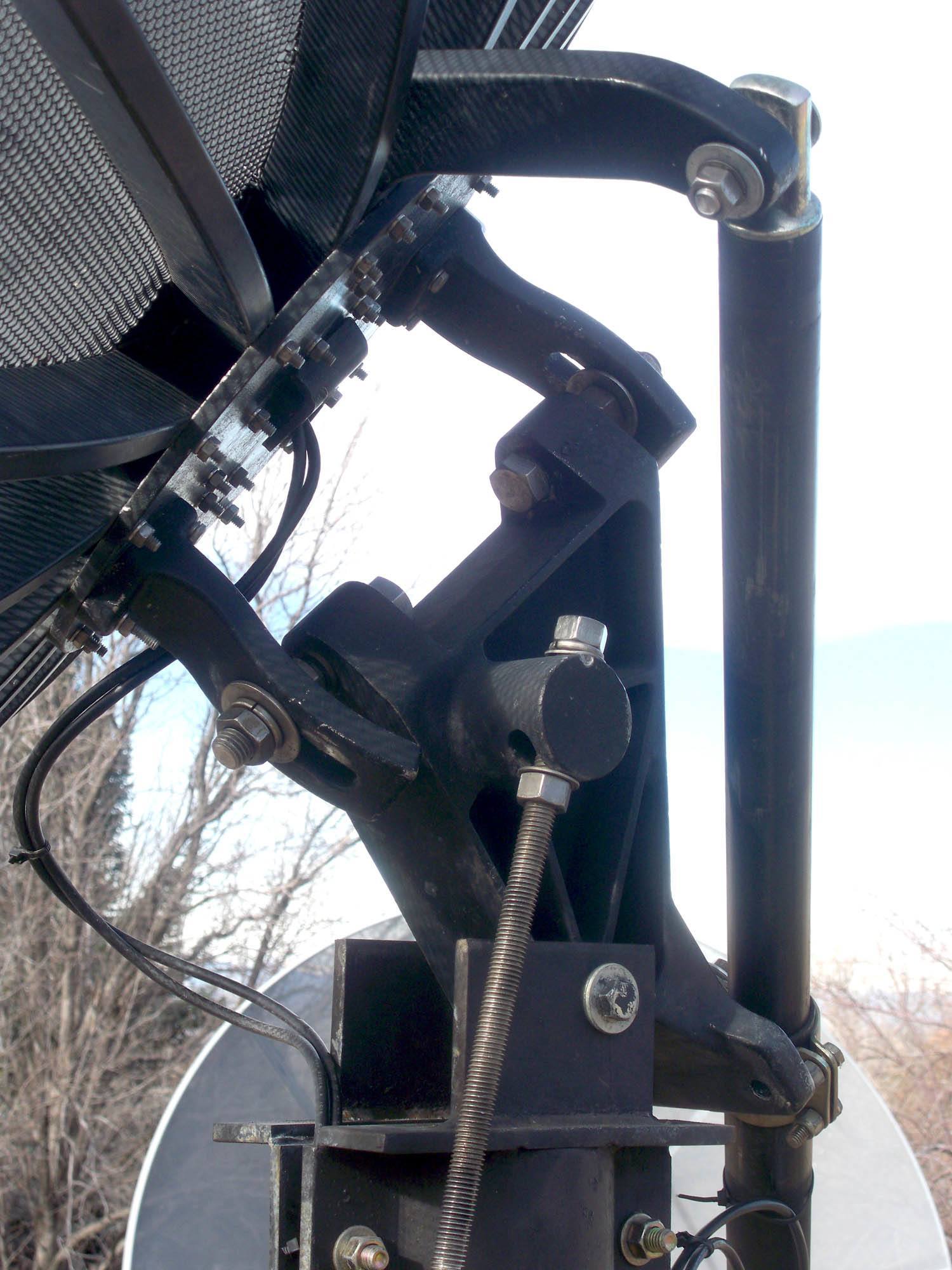

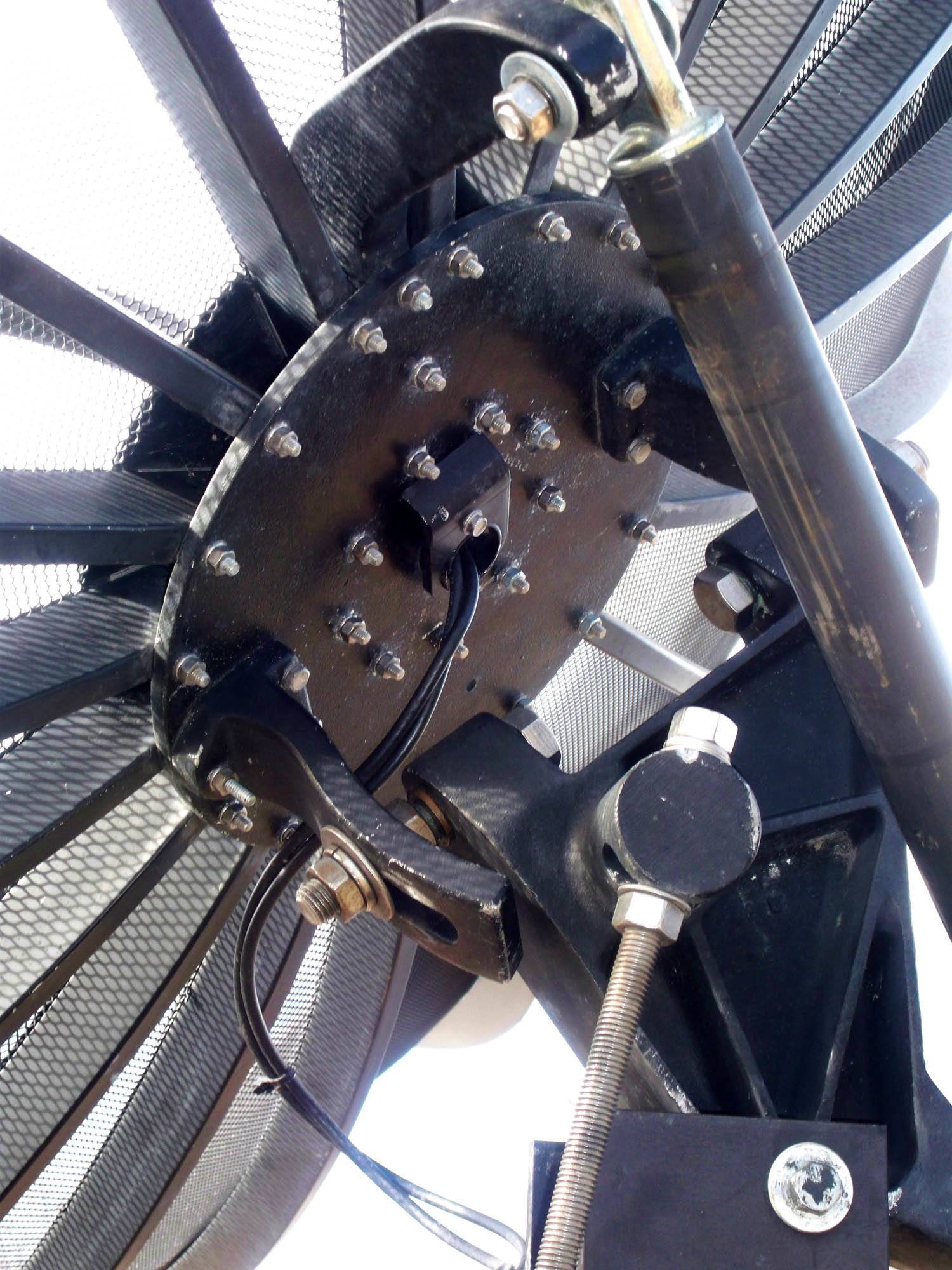

I did go get it, now in process of reassembling. I do have question on how the pole mount and dish attach together though, could someone email or pm me a pic of an assembled raydx.(especially a rear view) It is quite different from the SAMI and Kaul Tech mount. I could probably figure it out but a pic will save a lot of headaches.
I took a couple of shots that I hope will help. Ignore the actual pole mount in the pictures because the guy who owned the dish before me had problems with the stock mount slipping in the high winds we experience. He had a friend slap together something that is more robust, but rather crude. Everything above that point should be usable.

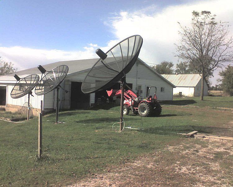

For a picture of the mount that I have on both of my dishes check out my post dated 5/22/2008 called"Cband Mount", at that time I wasn't sure what I had. Also
I attached a completed picture which may help you. If you need more let me know. I remember there was another posting of pictures of a newer style mount for the dish that someone had come across so you might do a search for it.
