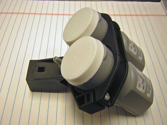

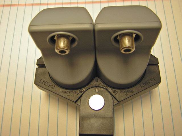

I have attached a few photos for one of the new twin LNBF 4 degree LNBF solutions that will be distributed with the Glorystar Christian satellite system. The solution uses 2 new GEOSATpro GSL1s Bullet LNBF (the smallest LNBF in the world) and has been designed for side by side mounting for satellites resolving at 4 degrees. The bracket rotates for 80 degrees of skew. This solution will be available with in the month.

sweet :)
One thing though. The StarChoice setup the LNB for 2nd satellite is "dead on" and not offset. 107.3 (main satellite) is :)
That is COOL!!!!!!!!!
