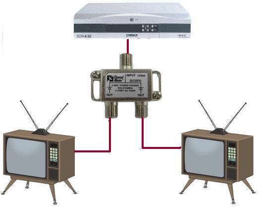

just add a rf spliter from the satellite receiver thats what I did :cool:
