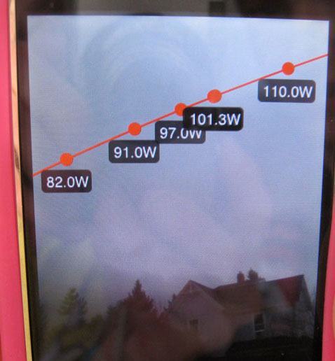

Despite following the directions in the wonderful Glorystar Installation Guide and using both the Dishpointer AR iphone app and printouts from the GeostatFinder website, we get nothing.

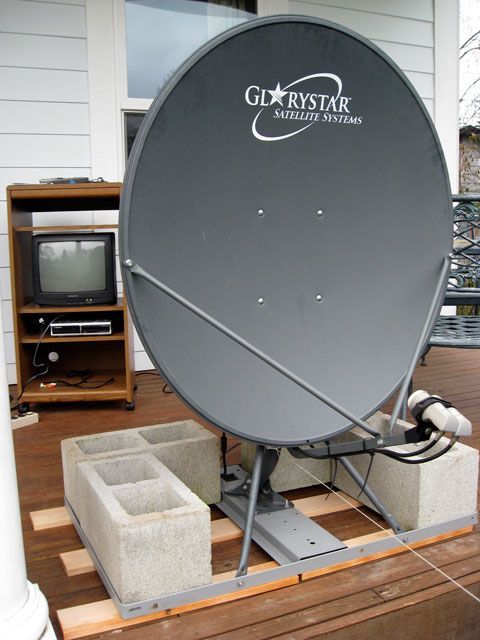

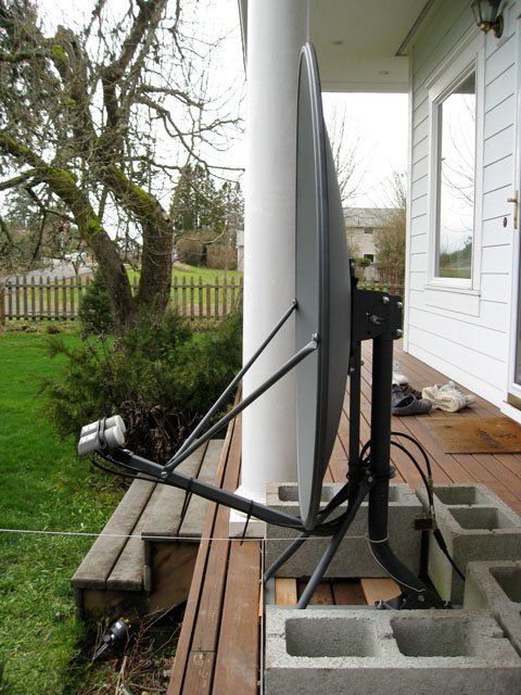

I've attached several photos of our dish set up hoping something obvious might leap out that we are doing wrong.

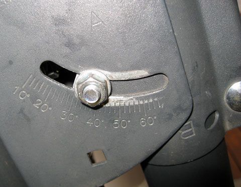

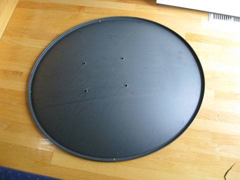

The Dish Elevation however, has us baffled. My husband doubled checked the plumb leveling of the vertical post as well as laying the dish on a flat surface to make sure it wasn't bowed. Yet when we tilt the elevation guide to the 30 degree mark, the dish itself is looking straight across the street at our neighbor's house with at most a few degrees tilt.
Does this particular Glorystar dish have a large offset angle and despite its appearance, we really are pointing the dish at a 30.3 degree elevation? It is slightly oval in shape and a little over 36 inches long.

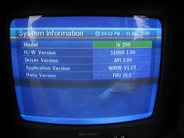

The receiver and all its settings is pretty Greek to us at the moment. We could easily be missing something here. I was able to find this info on one of the menu screens:
Model IV 200
H/W Ver S1000 1.00
Driver API 1.0
Application Norw v 1.15
Data Version FDU v 1.1

to answer the first question, no, it is not a large offset angle. However, if you look from the lower edge of the dish and up the arm, you get a better idea of where in the sky you are looking.

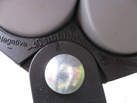

Next are the two bullets turned to the skew on that list?
Then as you look up the arm, aim it for the spot for 99W on your spoting app. Then SLOWly raise the dish and VERY SLOWLY rotate it back and forth looking for a signal on TBN, using the LNB for 97W. After going up around 7 degrees, if you have not found signal, then work your way back down to 7 degrees below the mark you started at. I have never failed to find the signal in that range. Remember a half a degree up or down in elevation at a time and about a pencil point width in rotation at a time is plenty fast. Do not turn anything faster than the speed of "Amazing Grace" .
Be patient ad keep us posted. TV and receiver at the dish during aiming is also almost an absolute.
POP
I almost always have found the signal between 3 and 5 degrees up from the markings.

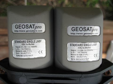

Hookup Just one LNB, the one on the left when facing the dish. There isn't much left on 101W satellite, so I would hook up the one LNB without the switch. Make sure your receiver is setup for the Standard LNB with a LO (local oscillator) frequency of 10750. Make sure your receiver is on an active TP (transponder) best one for search is 12152, Horizontal, symbol rate of 20000. Do you show signal strength? If not then something is not right with the connection to the LNB. Your dish maybe set a degree or two low - just looking at the picture. Hope this helps.

Based on my experience, most offset dishes have an offset of 21 to 24 degrees. If you are supposed to have an elevation of 30, then your dish should have a tilt back of about 6-9 degrees not vertical as your pictures show. I had a 24 degree offset dish aimed at a satellite with an elevation of 28 degrees and it was not quite vertical like your's is. You might look for some specs online for the Glorystar dish and try to find the offset angle. I would be surprised if it were anywhere close to 30 degrees which would require the dish to be vertical but stranger things have happened.
Then like rv said, slowly rotate the dish until you find a signal quality then fine tune the elevation, if your original elevation is close to correct you should be on 97 or very close.
Also, just to be clear, which lnb are you marking as #1? If you are standing in front of the Dish, it should be the on the left.

I did a quick search and found the following link, the 90cm dish is a 24.6 offset angle and the 120cm dish is a 27 offset.

something i just noticed from your iphone app pic.....your LNB is skewed/rotated in the wrong direction.....you should be rotating it counter-clockwise instead of clockwise....when looking at the LNB from behind the dish.....
It is rotated correctly for the Northwest, click on the Picture above and you will see that minus is clockwise when viewed from the front of the dish.Skew.JPG

The way that the NPRM base is placed on the porch will prevent the dish from sweeping left or right without contacing the support tripod legs. I would rotate the NPRM 180 degrees to get the tripod legs out of the way. The LNBF rotation (skew) is correctly set for Washington State.
Follow Wescopc suggestions for bypassing the switch and directly connecting only to the left LNBF (labled LNBF #2 on the bracket) and tuning to transponder frequency 12152.
The elevation pointer in your photo is set at 28 degrees. The dish wshould be tilted back only 5 -6 degrees from vertical to be actually aiming at 30 degrees. The dish makes people think that it is picking up signals from the angle that the reflector is pointed, but the offset design is actually pointed at an elevation that is 24.6 degrees higher than then the reflector is pointed! I would start at 30 degree setting then SLOWLY sweep the dish 10 -15 degrees to the left and right of compass reading 129. If the Signal Quality reading does not increase, tilt the dish up or down in 1 degree increments and repeat the SLOW pan of the dish.

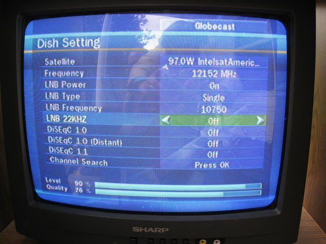

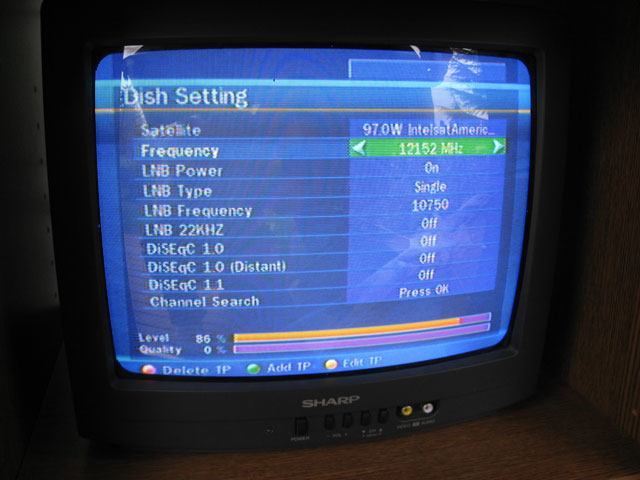

We have read everyone's suggestions and have made the following adjustments, yet still no signal quality.
1. We switched to LNB #2 (the one on the left as I face the front of the dish). We are connected directly, bypassing the switch that use to connect the signals from the two LNB's before heading to the receiver.
2. We selected the frequency of 12152 on the 97W screen page
I've uploaded two photos. Have we overlooked any entry or maybe left something marked "off" that should be "on"? The Dish Setting photo is the screen where we have been looking for any change in the signal quality as we slowly move the dish. We can make the Signal Level move from around 80 to as high as 87. The Quality regardless stays stuck at 0.
The second photo is merely for reference as to the model and firmware info for our receiver.
Since the Glorystar double LNB set up was meant to shoot in between the two satellites of 97W and 101W, should we change our LNB skew to that of 99W? It isn't much of a difference, -20.21 vs -21.82.

assuming your post is level set your elevation at 30 degrees and sweep VERY SLOWLY back and forth....if nothing increase the dish elevation by a degree and sweep again....keep doing that till you get to 35 degrees....after that start at 30 again and work your way down to 25 degrees.....you should get something....
i am not familliar with the lnb that you are using so maybe somebody else can varify the lnb freq....that is the only setting that could possibly be wrong.....everything else looks fine.....

One more voice in this thread should not confuse things too much I hope.. Sometimes it is the simple step that gets overlooked and can keep us from finding that satellite.
1. The two LNB bracket if you must use it (I'll get to that later) should be set with the skew setting for the satellite between the two satellites 97W and 101W, which is 99W as stated above. Once you set that elev on the bracket, don't change it. [Where I am, in central California, the two LNB settings are -27.7 and -23.5, so the bracket is set at -25.4 for 99W]
2. The two LNB's should be set 3/4 inch from the face of the LNB to the edge of the bracket looking from the top. When (not if) you get the satellite locked, you can "tweak" (turn left/right and slide in/out) the LNB's for the highest QUALITY. The line at the top of the LNB should line up with the line on the top of the bracket to start.
3. Facing the dish front, the LNB on the left is always called LNB#2 which is also pointed at 97W.
4. Some people have assembled the dish bracket upside down, but yours looks correct from the picture with the "A" visable.
5. If all else fails, you can get a single LNBF bracket from Glorystar and it will be much easier to lock one satellite only; and that would be 97W. The Directv satellite at 101W is a pretty strong signal and causes some problems for installation.

We have signal quality!!!
Within 10 minutes of my last post, my husband started to get hits on the quality. He peaked at a signal level of 90 with a signal quality fluctuating between 75 and 79.
Moving to LNB #2 and taking a much SLOWER approach to moving the dish systematically left/right, then SLOWLY raising the elevation did the trick. We ended up with a dish elevation marking on the post of approximately 34-35 degrees and it appears our compass reading of 130 degrees may have been off a bit because he found the channels closer to a compass heading in the high 120's.
We scanned all channels on 97W and found 185 TV channels. When we scanned for FTA only, we got 140.
Is a signal quality of 75 to 80 more than adequate, or should we attempt adjustments anywhere else, such as the LNB?

If picture 6 of 7 is showing the LNBFs looking from the dish, they are skewed to the right. If you are in the Pacific Northwest, the LNBFs should be skewed in the other direction!

I know we still need to seek out the most current/stable mfg firmware for the Visionsat
If you have a NORW version, it's a pirate version. It WON'T hurt anything, and MIGHT be better than the last factory version (the Coolsat's was.)
(Other readers please note, this doesn't go for all receivers and all firmware. There are some brands where, if you're not pointing at a Dish satellite, it doesn't want to work at all.)
I obviously don't want pirate firmware. I've searched the forums and seen references to a mfg firmware version 1.45 (if memory serves) If I download and reinstall this firmware, does that get me back to a standard Visionsat receiver?

BTW Your skew has to be correct and to the minus side - if you were skewed in the opposite direction - you would get nothing.
Yes the 1.45 appears to be the latest factory file,and yes it would return the receiver to factory status.Just go thru and write down your settings in the menu if you cannot remember them,do a factory reset and download the 1.45
file,reset settings and rescan the satellites!
yes it will. I just got 2 of these a couple weeks ago and both had old pirate firmware in it. Loaded the software, did a master reset and was good to go :)
