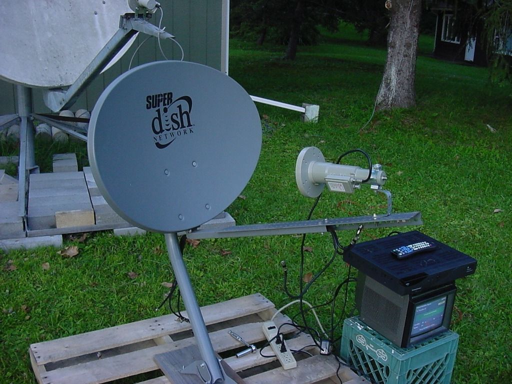

I played around with this setup last summer when others were having better luck. I was pointed at 105° during this experiment. The Superdish is just too small.

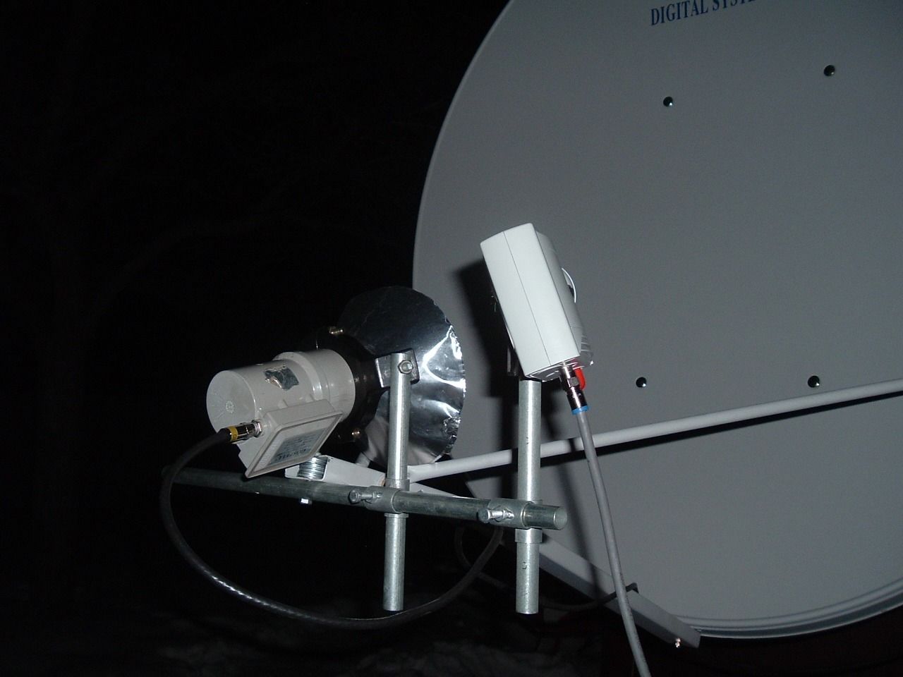

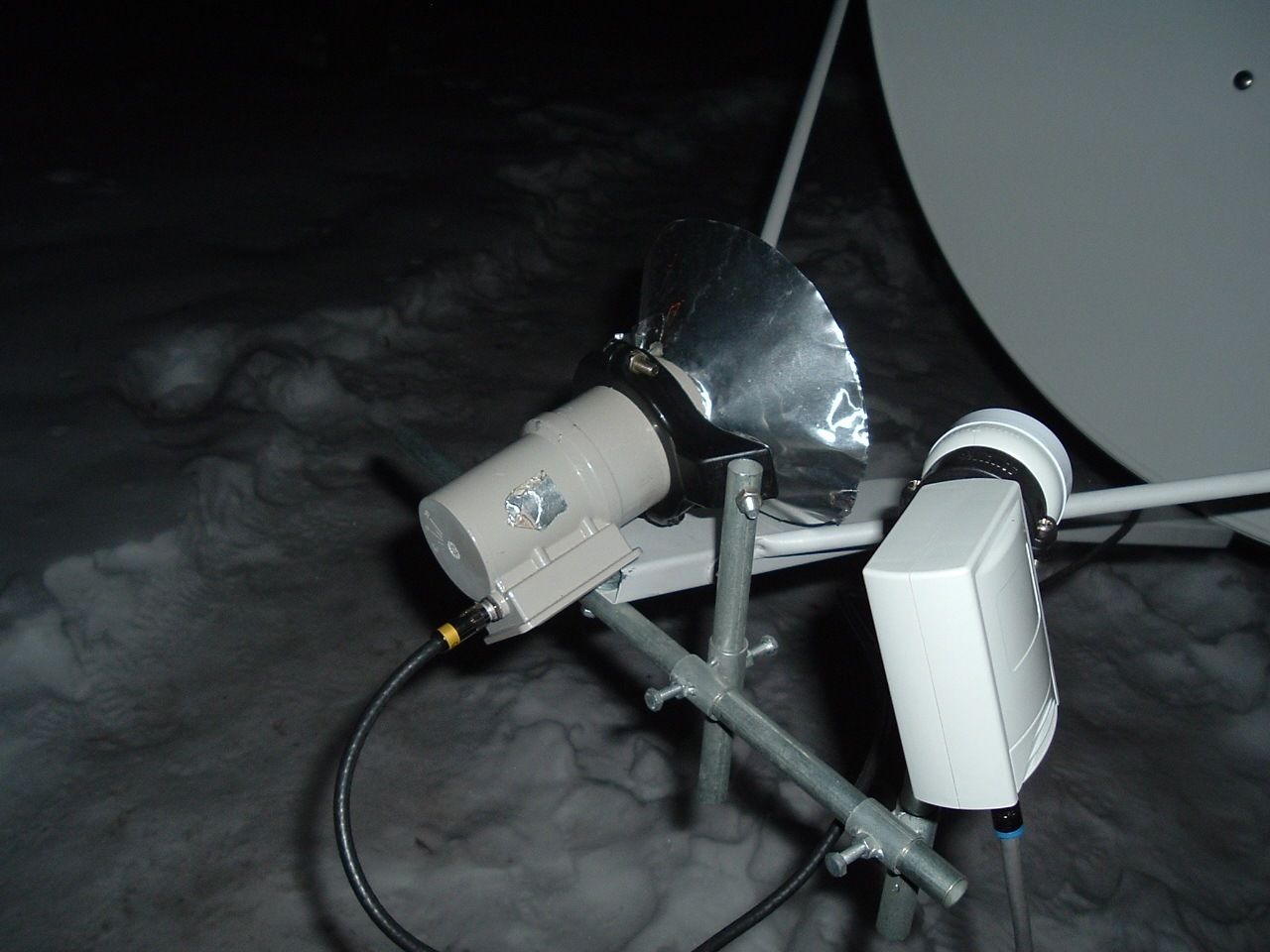

I tried the 39" in toronto and had very low signal with the first version of your tappered rings. Then with further reading I added the 3rd ring and found a impressive improvement but still very hard to get a clear picture that was reliable to watch. I dropped for a 1.2 and motorized it. NOTE the sg2100 has a really hard time moving this dish! As for signals, I get most channels on galaxy 17 with a signal of 66 to 70%. On galaxy 16 I range from 24% to 58%. Whats interesting is at 24% the picture is perfect. The motor fried turning the heavy dish before i could get to 121 or 123. Once the weather warms up I'll manually turn to 121 and 123. Also I found that my gospel lnb worked better then my 621, this lnb is junk. The dimentions that I have are for the cutouts. Small= 90mm inside-140mm outside, med=90mm inside-200mm outside, large= 90mm inside-260 outside. Thanks for all your hard work on this project. If a usals motor is out there that can handle the weight of the 1.2 dish easily this is a great alturnative to vbox's and a sea of 37volt wires.

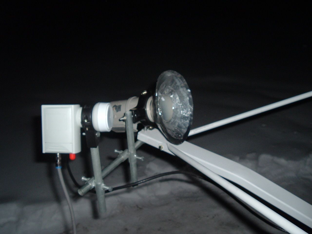

Well you have got to be kidding me there's a reset lol!!! Man you would not believe the messing around I had to do. Oh well live and learn. The motor stopped after going for a full sweep down to 131 and just would not turn back up. Thats probabbly all thats wrong. The rings I made out of dollar store oven drip trays. They are a little fimmsy but with the aluminum tape they seem to work until I get my hands on something better. Thanks for the tip on the hh120 comptech maybe I'll look into it if this thing is toast.
Some pictures. Some damage from the snow to the rings but still working.
