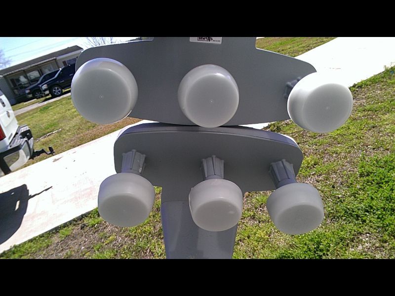

What lnb came with the dish? Compare the spacing of the lnb's on the .2 to the .4. EARC lnb's have a different spacing. That cold be the problem. If the .2 works, why are you trying to replace it.
Which LNB set do you have on the 1000.4?
The top one in this picture is a 1000.4 WA LNB. The EA LNB has an offset look.

I have the right LNB for the 1000.4, it came with the dish that I bought. The .2 LNB won't fit on a .4 antenna.

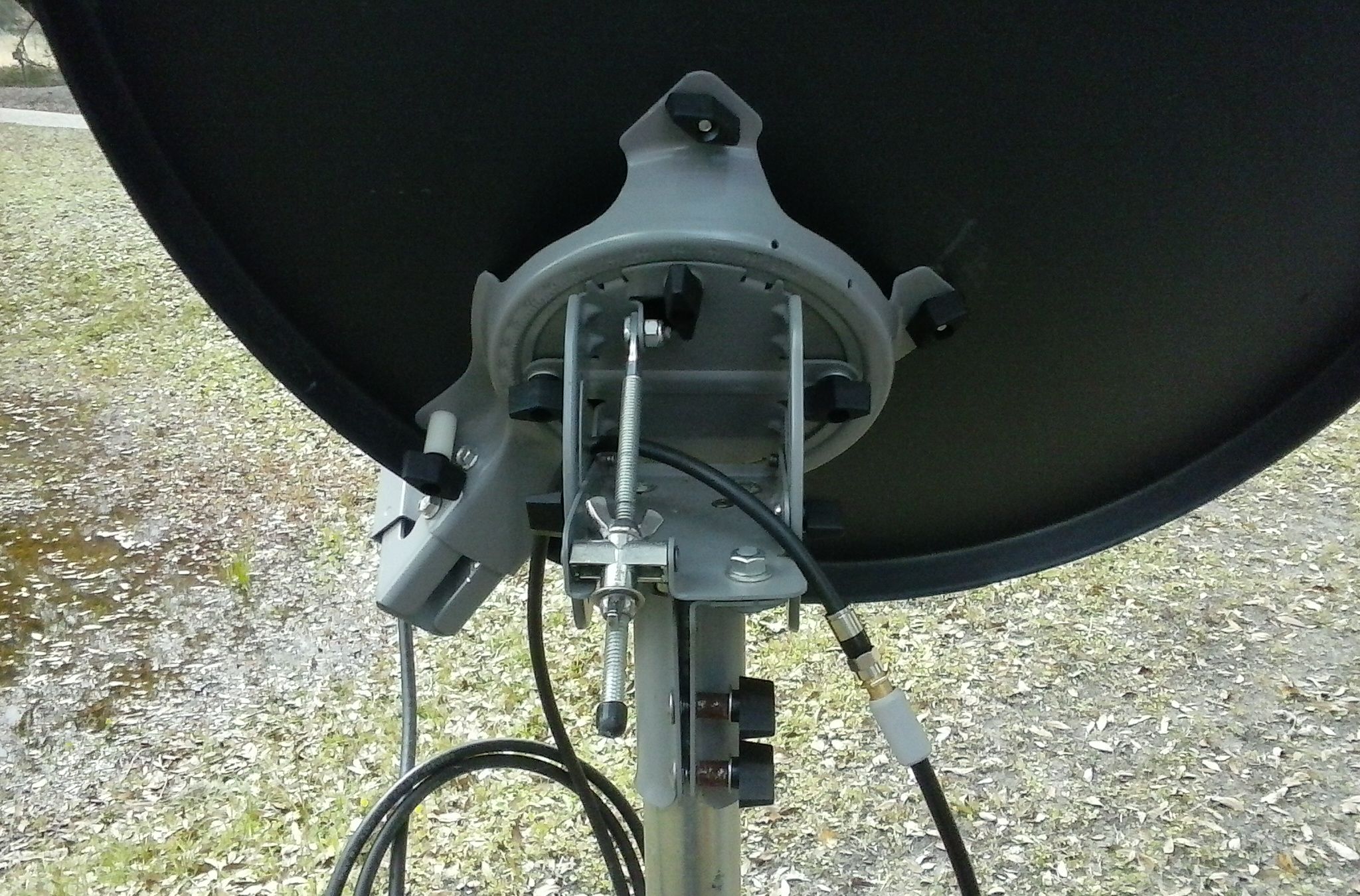

I modified our portable 1000.4 for even easier assembly and aiming. My total setup and aiming time is typically under 15 minutes.
