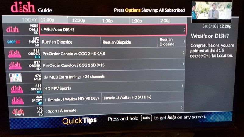

The last three days when I first use my Joey 2.0 the guide is locked on the last seven unlocked channels in my channel list. I can scroll up and down among only these 7 channels.
I can exit the guide and input any channel I want to go to and it works.
If I press guide from there I get the same 7 channels as when I first turn the TV on.
Essentially the only guide I get are those 7 channels.
The only way out of this seems to be to do a power cord reboot, sometimes twice and the regular guide finally shows up.

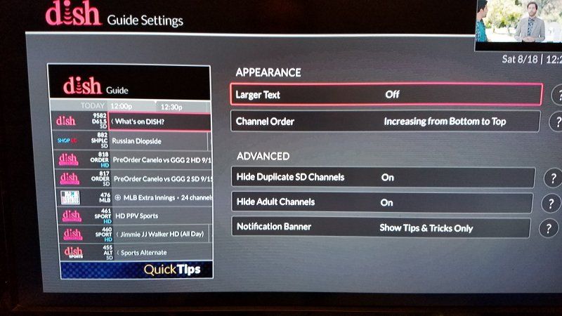

Here are photos of my guide settings, all looks normal.

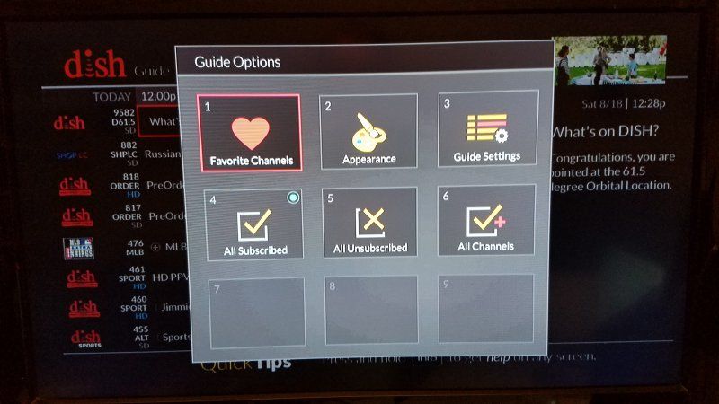

Press the guide button twice. Look to see how your favorite settings are set. Try selecting none. Your guide should show all of your channels.

Same guide as shown in post #1.

I have the same sort of issue on my Hopper3, when the guide comes up showing my Big10 and PAC12 RSNs I can't scroll until I close the expanded RSN listing. My workaround is to create an altenate guide view (AKA favorites) that has no RSNs in it. If I want to watch one of the RSNs I just use the default all guide view.
Long story short, try creating a favorites list with your most common channels and make that guide the default list, see if that helps.

Well, I went to the Hopper menu and changed the size of the font and the guide is now working correctly.
