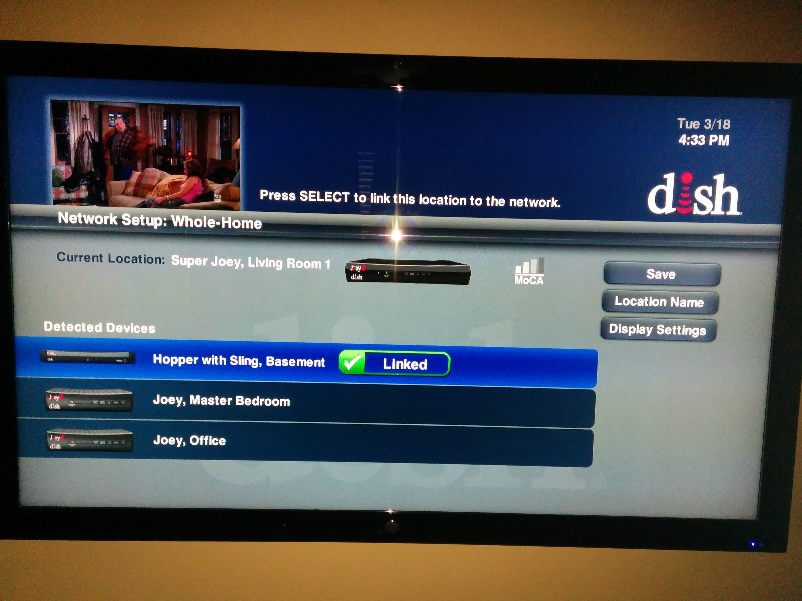

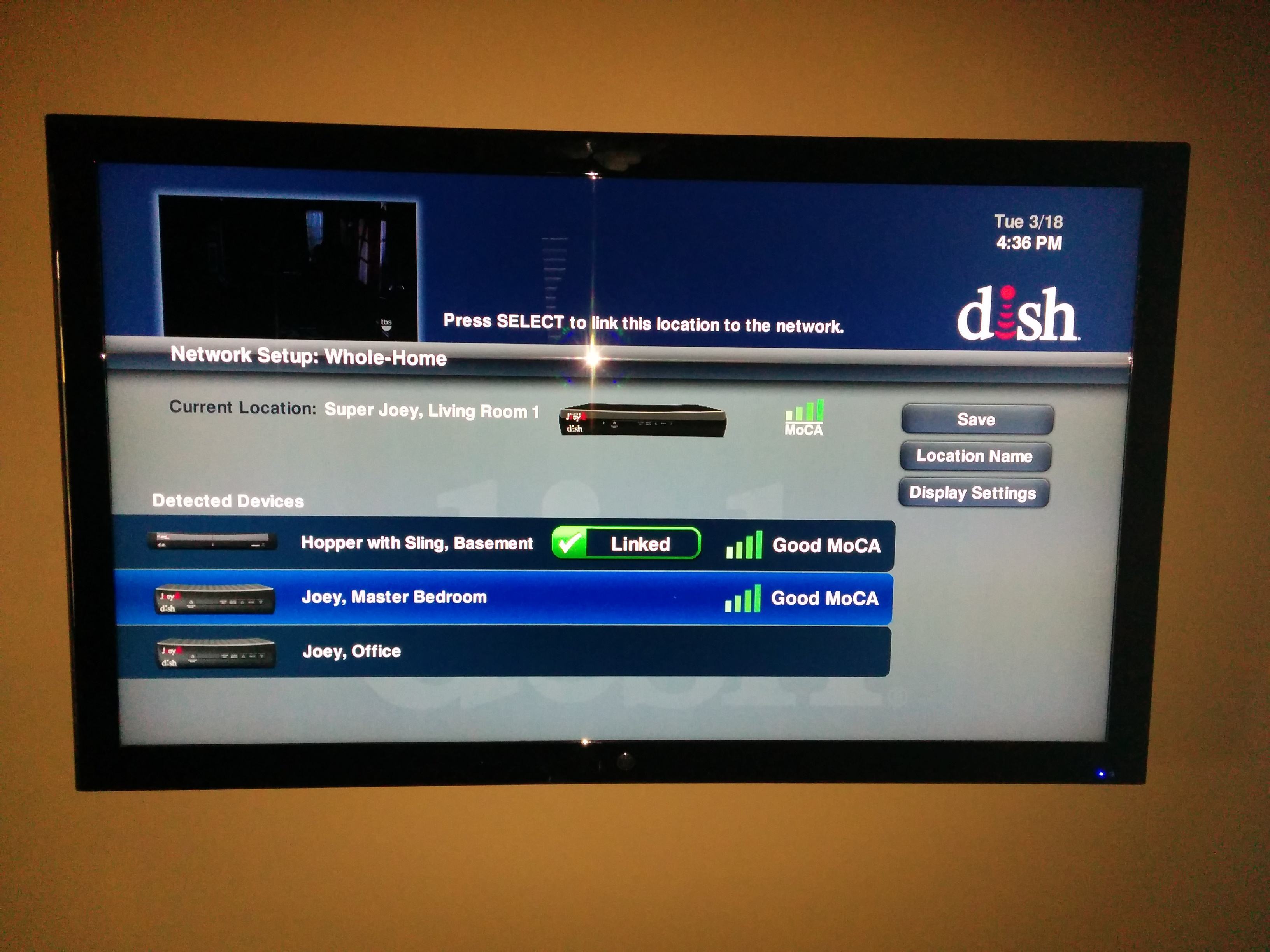

IMG 20140318 163340 IMG 20140318 163706
I disconnected the line from the splitter to the integrator, and yes, the ethernet was used instead.

Fantastic work. It is interesting that the "MoCA" connection became stronger.

Apologies for the confusion, but I actually disconnected, took the picture on the left (No MoCA connection), then reconnected it and took the picture on the right. I'll go disconnect it again and see how the tuners work on the hopper.

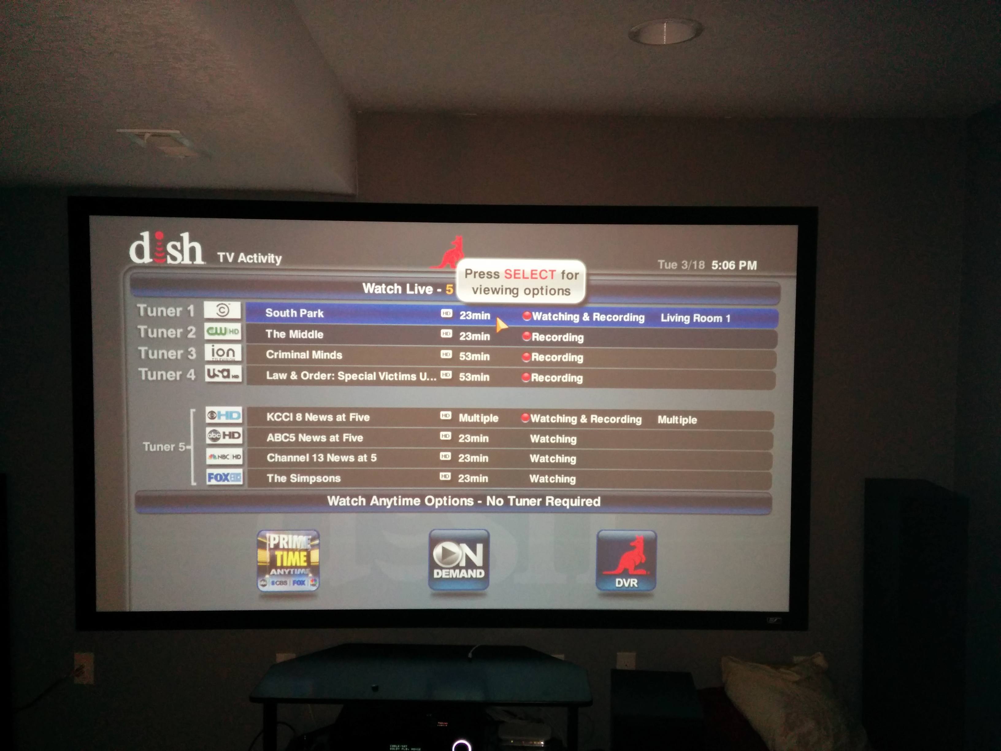

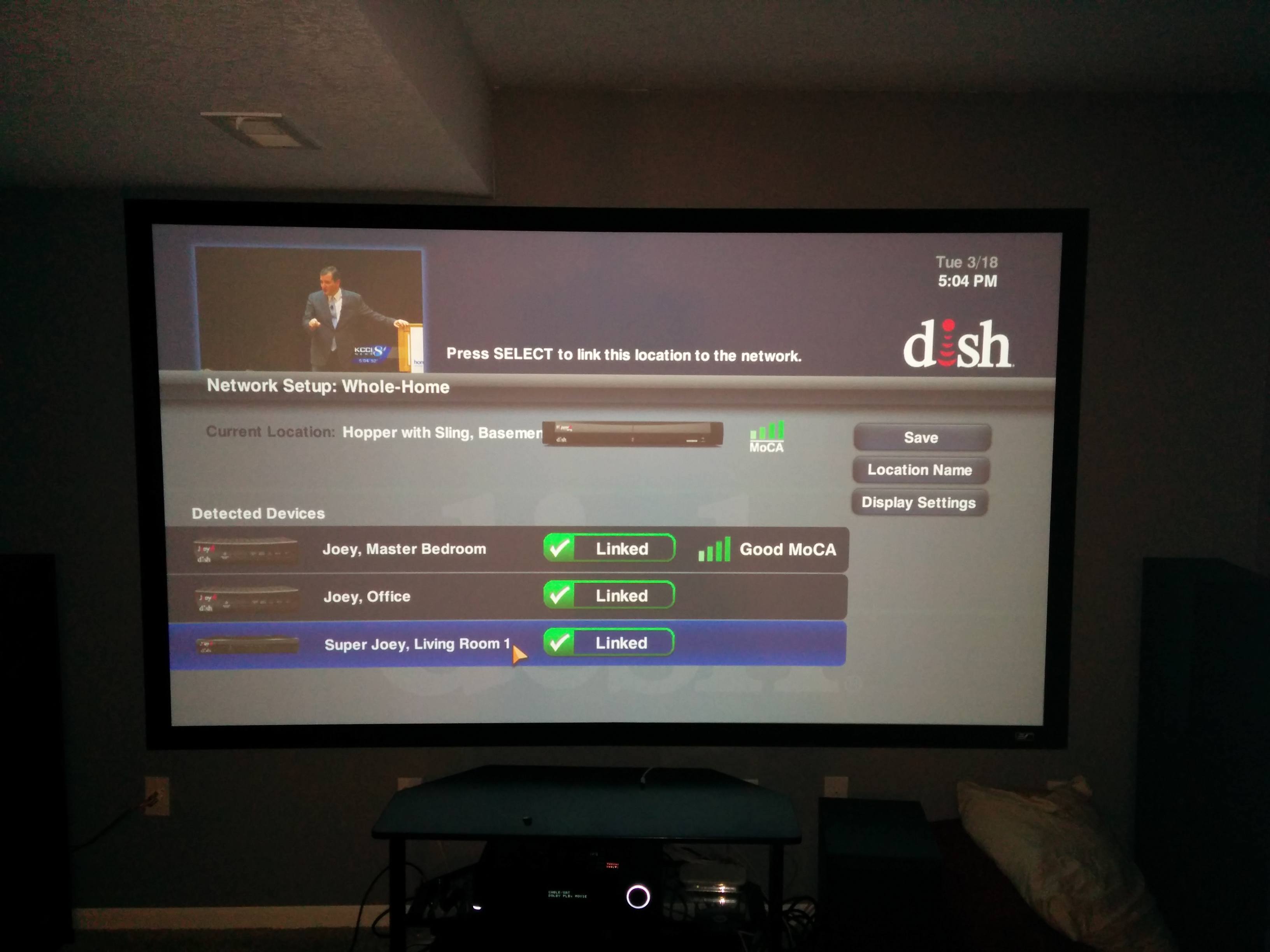

IMG 20140318 170431 IMG 20140318 170655
Image on Left shows MoCA disconnected. Image on right shows all 5 tuners in uses recording. And with that, my work here is done.
There was no difference in performance on the super joey with MoCA disconnected. The super Joey is much faster than my Joey's in general, however.
