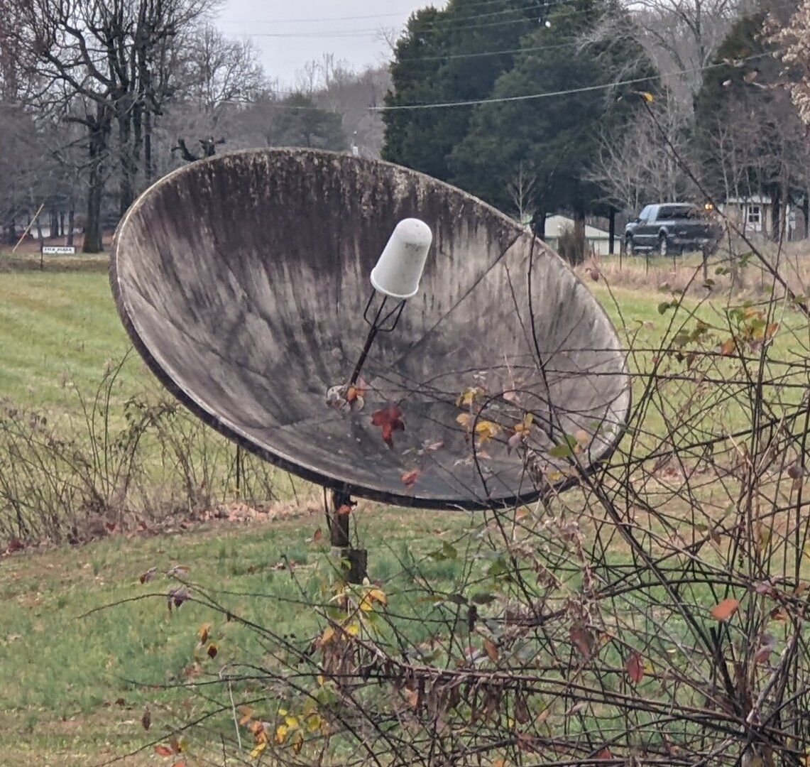

Looking for help with this old C Band dish on property in KY, the LNB looks newer than the dish itself, I don't know anything about it I do know the previous owner lived there for 20 years and didn't use it, I want to use it to it's full potential, any suggestions on how to get it going? I don't have any photos of the positioning motors on the other side one had a brace on it probably because it's broken, there supposed to be 2 boxes for it in the house I have yet to find, what reciver should I get, how do I fix and control the positioning if the boxes are not found? Also does the LNA look good? How do I test it? Sorry for all the questions I'm clueless about it. I can post more photos when we actually move it around Jan 1 2022. Thanks for any help

Really no way to test the LNA/LNB without hooking it up to a working receiver. You can test the actuator (motor) with a 12V car battery and you may be able to move the dish manually with one of the boxes in the house. :)

That's a REAL OLD one. It's likely fiberglass, and very heavy. Since it's on the property already, you can probably use it. I wouldn't advise that for anybody that had to go remove it somewhere else, to transplant it on their lot.
Ok, so likely NOTHING on it now is usable. You'll have to replace the (likely) LNA with a newer LNBF, replace the old actuator (that's likely a potentiometer type) with a reed switch model, AND new wiring to the house, along with a new fta receiver and positioner.

Thanks my next question was how to clean it? But you answered it. Will I have to paint it if it's chipped? I know it's been there a long time not far from where the tornado hit in Kentucky I saw what it did only a. Few miles away from where the dish is mounted, I did notice it's set in a very large concrete slab guess that's why it's still there. But again thanks for the advice it will save me a fortune over paying for cable or DirecTV.

You don't need to paint it, though IF you do, use a flat non-glossy paint, such as a dull gray, or cream. IF you use the CLR, make sure you have good thick chemical proof gloves on, and perhaps a respirator.
Those prices I quoted are for brand new equipment. If you can scrounge some, or get donations, it would of course be cheaper. IF I was YOU, and didn't know as much as I do about these, I'd be inclined to take a LOT of photos of it, post them HERE, and ask more questions about IF we think it's restorable.
The very FIRST thing I'd do, is make dead SURE the mounting pole is absolutely level, North-South and East-West. IF it isn't, you need to fix that before you do anything else. IF you can't, it'll never be right, and any money will be down the rat-hole.

Maybe measure the diameter of the dish, and do a string test. (put "string test" in the search at the top of the page).
If you can remove the feed horn cover take a picture of the feed horn assembly. It's likely going to be replaced, but a picture might determine if a newer scaler/feed horn mount will work.
A picture from the back too would help in determining the type of mount and what actuator you might require; 24" or 36". There might be adjustments on the mount for compensating for a non-vertical pole.
The way I read the OP... it will have to have to be relocated. Whether on the same property or elsewhere seems unclear.
Personally, I would search around for a good mesh or perf dish instead. Man handling that beast will be a chore. (But that's just me)
I believe you are right about it needing relocated. On first read of the OP's post I thought it said 'when we move in' but it does say 'when we move it'.
Moving a large old fiberglass dish will be a job. Still, dishes are getting harder and harder to come buy these days so if the OP has the will and the way then more power to them. :):thumbup
Ah... Maybe "I can post more photos when we actually move it around Jan 1 2022." was just a typo. Probably should read 'move in'.
