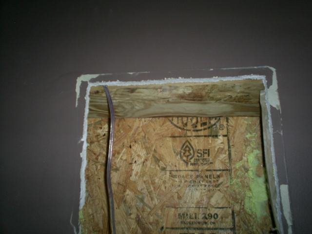

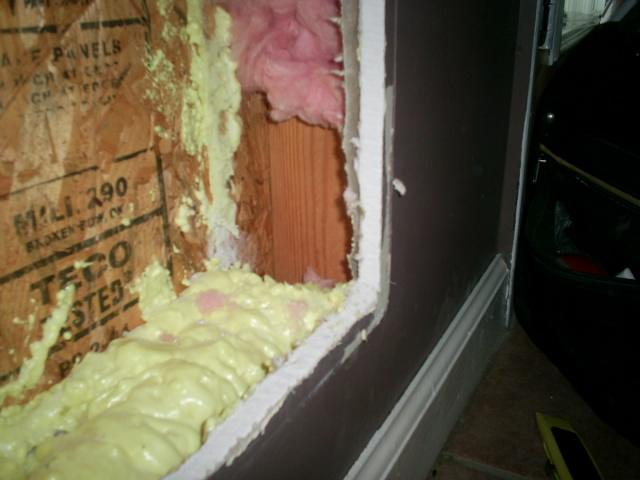

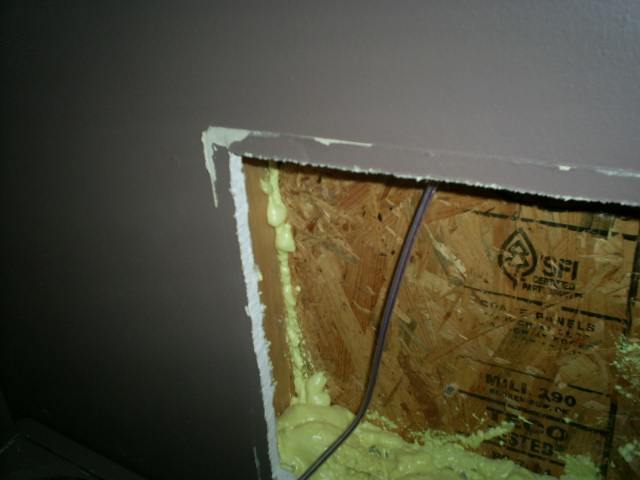

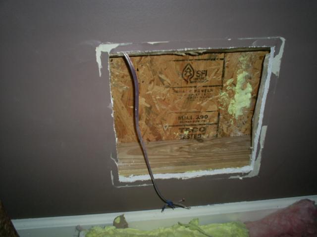

I am planning on taking the sub out tonight and i will post some pics. I did brace were the wings on the screws tighten. There is no additional bracing in the wall around the sub except for the studs on both sides which should be seen in the photos. there is nothing on that wall except a painting that has no plastic or glass. Just a wooden frame with the canvas wrapped around which is not causing the problem "I have taken it off and same results". I do think it is the sheet rock itself that is causing the problem.
Hopefully this fixed the issue. I will let you know in a couple of days as I get time to test the system. I also added a layer of insulation around the edge of the sub between the wall.

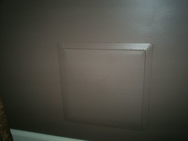

Well I am going to say that fixed the problem. It has alot more bass now also, probably because its more stable. Today is the first day I have really got to test it and it blew the grill off the front.
BTW, I'm fairly impressed with your solution. Nice job of figuring out the vibration modes and eliminating them without having to do any cutting. I especially liked the plywood backing you added.

My wife is anal about having stuff sitting in the floor. Its the only way she would let me put the system in. I am actually surprised at how well the speakers blended into the wall and ceiling. After I painted it all you cannot really tell there is anything there unless you are looking for it.
