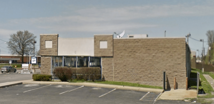

Does it look something like this? This one was behind a former bank/Blockbuster/abandoned building for years. I never did get a response from the owner, so it's still hanging around, slowly rusting away. The LNB on it is Ku band, the reflector around 2 ft x 4 ft.
Now I'm anxious to hear what he says they said to him.

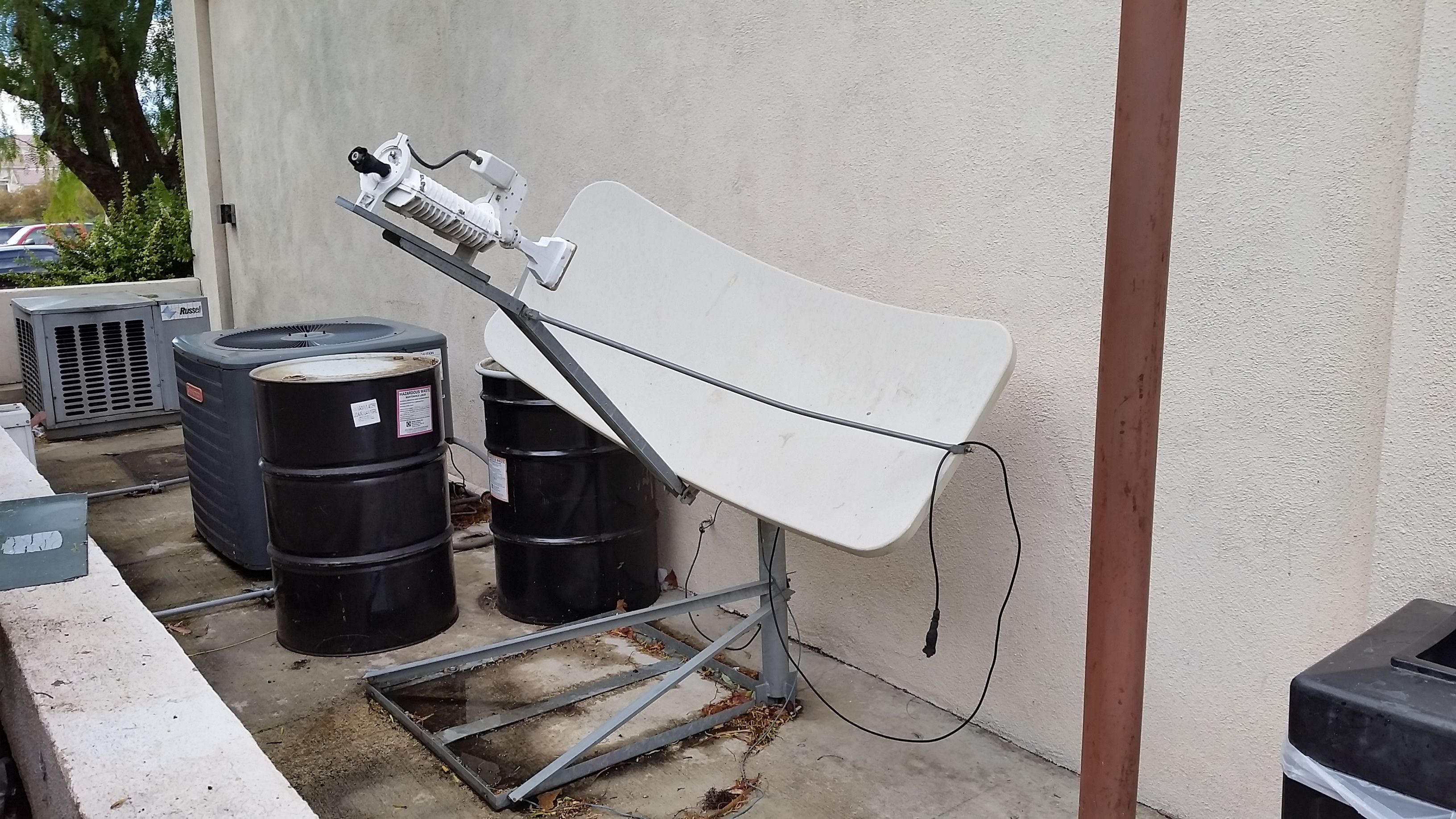

Ok ... I made a quick run down the street. The place that has the dish is a Circle K. I know the guy that works there. I ask him about the dish but he didn't know anything about it. He said, "They don't pay me enough to think" :biggrin. I left my card and he said he'd give it to the Owner. And yes KITTY ... it looks just like the pictures you sent. I took a closer look at it this time and it said, "Hughes Personal Earth Station" on it. So, it must have been Satellite Internet at one time. I've attached a picture that I took. If they call me back, I'll let you'all know what they said.

Can't locate the specs right now, but as I recall they are equivalent to an 80cm. Good surface accuracy as it is RX/TX compliant. As FatAir points out, with the exaggerated horizontal plane, use the OEM feedhorn or it will over-illuminate the vertical axis and have very poor performance..
