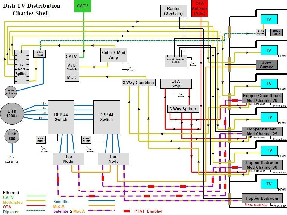

Here is my wiring diagram for a four Hopper and one Joey system. I have a spare DPP44 switch and thinking of cascading it with the two DPP44 switches and add a purchased Super Joey, then see if Dish will activate it. If Dish refuses to activate or it doesn't work I could sell it on ebay. My present Hopper/Joey setup, all Hoppers can see each other and the Joey can see all four Hoppers. I would like for the Super Joey to be able to do the same thing. I could experiment and try different things and see if the Super Joey can be blended in with all Hoppers as long as no damage can happen to any equipment. All my switches and nodes are located in one area (see avatar pic) so it would be easy to try different setups. Does anyone have an input or do you think adding a Super Joey is a bad idea?
nice, I'm curious if the super joey would work with 2 hoppers

if wired in a certain way, most likely (It was discussed in other threads). Nobody has actually tried yet.
The hard part will be seeing if that special department at Dish will allow you to activate the Super Joey with two hoppers as I don't think anyone has tried that either. Probably worth asking DIRT if it's possible.

I think it would work too based on wiring diagrams that have been posted. I had to talk to the special department when I got the Hoppers and it was no problem getting set up. But, I am not so sure this time adding a Super Joey to four Hoppers. I think I would just purchase one and connect it up and then call them. I would think they would but you never know. If they won't authorize it, I will sell it.

But, don't the geek in you curious and want to make it happen? You are the one that figured out how to make the more than two Hopper setup to work and all Hoppers and Joey can see each other. That was awesome 3HaloODST. Go for it.
I would be very interested if they would #1 authorize it and also if it works I wold love to add two more tuners to my three hoppers. So please keep us up to date.

I didn't think the system allowed 4 Hoppers, but someone figured out how to make it happen.
The excuse E uses is MOCA bandwidth but 4 Hoppers obviously use more bandwidth than 2 H 1 SJ.

I think it would be a terrible idea for me to try it.
But you? I think it's a great idea for YOU to try it! :D
