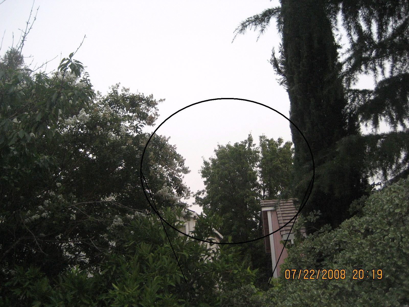

My View
This is what my view looks like from my 36" dish, I have just enough clearance, and I get very strong KU signals. My backyard is heavily covered with trees. My next only option is from the roof, which I don't want to do.
