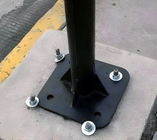

Perhaps this is why I've never installed a pole for a satellite dish.
That's pretty messed up, looks like the anchors were set for a different size pole/base plate that's been changed out.
Base plates are the best way to do it, and if one is afraid of missing anchor bolt holes, just set 1 anchor and use post-installed epoxy anchors w/ 3" or more embedment for the other 3. (I'm a structural engineer so I deal with stuff like this all the time). Ideally, you'd use a plywood template when you set your anchor bolts, that's the best way.
