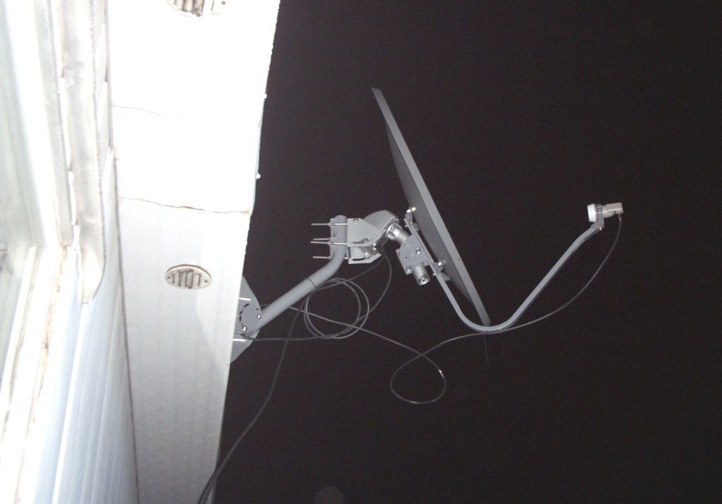

I don't know if this will help, but attatched is a lousy picture of my setup.
The dish elevation is set to 24, the motor elevation is set to 50.

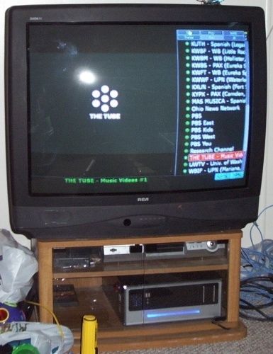

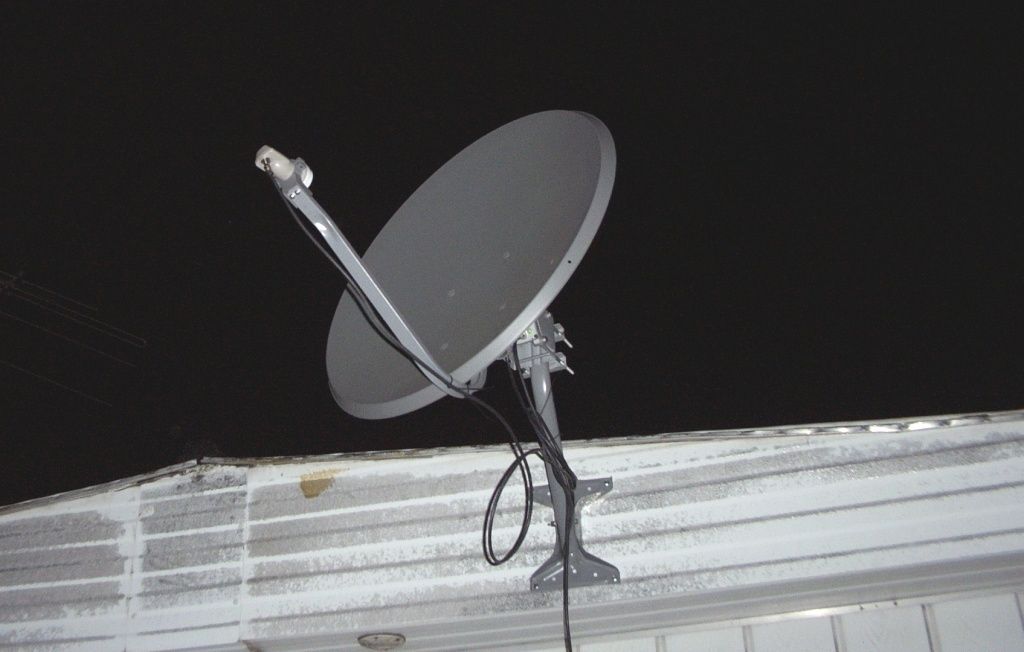

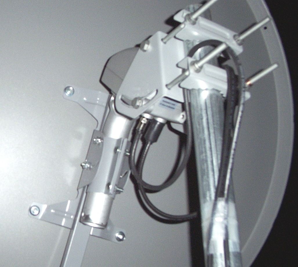

EDIT: Never figured out why USALS refused to work, but got the setup alot more stable. Yes, you were right, Iceberg... it didn't move MUCH, but it moved enough to jitter the picture apparently- so no more huge pole. Attatched is some pictures of my much more 'responsible' setup, and a shot of my HTPC in action ;) I still only get about 34% quality on The Tube, but the picture stays whole 90% of the time now instead of 50%. I'm having a heck of a time tuning everything back in, but G10, AMC4, and T5 is plotted out... wife'll be happy for now.
