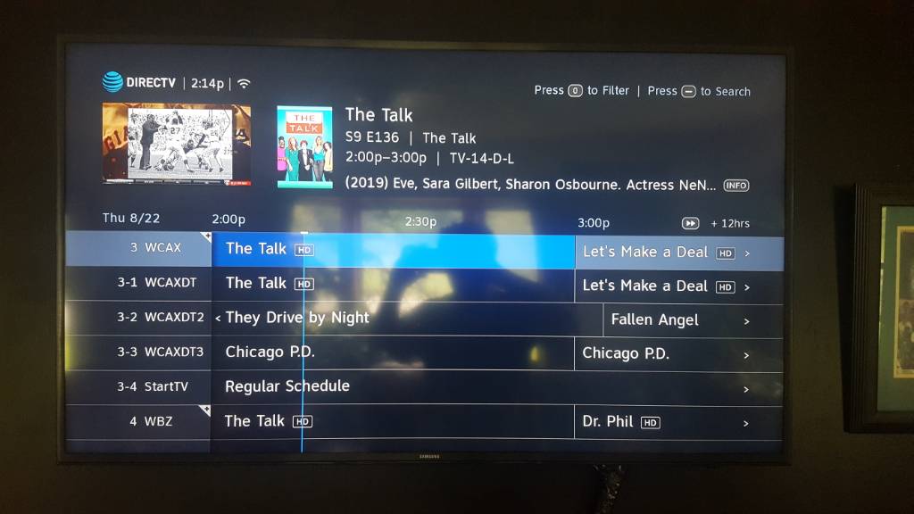

They are sending you a thingy and an antenna. It sounds like you have your own antenna. Use your existing antenna and the thingy they send and follow the prompts and it will work. It connects to your receiver and puts your OTA channels onto your Directv system. I will post a pic in the next post. You will see the satellite feed of 3 WCAX (Vermont CBS), the OTA feed of WCAX and their Movies, ion and Start TV subchannels.
The guide data for the OTA channels comes from a database, not the OTA channels themselves. The database only has full power channels in it, and low power channels that are affiliated with major networks. If a channel is not the database, the channel will just show regular schedule. In the photo, you will see that WCAX CBS, Movies, and ion all have guide data. Directv hasn't updated it since WCAX added Start TV, so you just see "Regular schedule". Of course, you can edit out the doubles in a favorites list. In mine, I don't have the OTA -1s because they are not needed unless I don't have the satellite version of the channel. If I need to tune to them, you can manually.
Here is the pic
