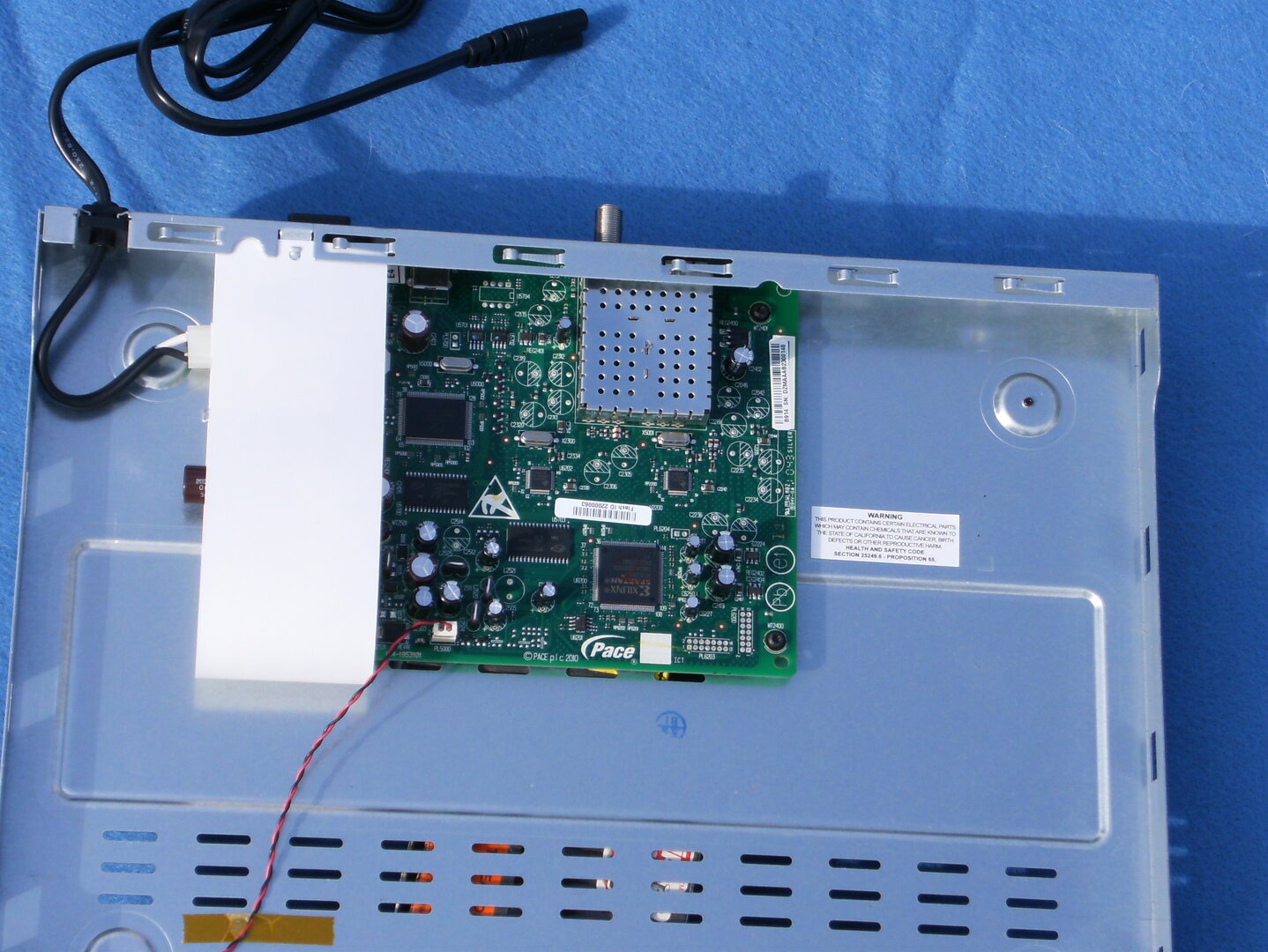

The AM21 has an internal power supply. Attaching a picture of what it looks like inside. The only thing that protrudes is the power cord.
If you have the original AM21 with the polarized D7 connector on the end, you could easily cut it off and replace it with a standard US plug.

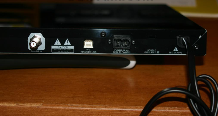

1. The AM21 should have a polarized C7 cable that connects into the power input in the attached pic. This is just a cable, not a power supply, and you can get one from a lot of different places for under $5.
2. You have choices with the cable that's attached to it. You can ignore it. Or, you can remove it if it's bothering you, I guess. Or, you can cut off the connector and attach an outlet to it, and plug the HR54 into that outlet.
One more thing that occurs to me is that if you wanted, you could remove the attached cable, put a plug on the end of it, connect it to the power input, and you've got a power cord.

OI did the Last thing you mentioned ...
Cut the cord and added a plug and plugged it in to an outlet ...

I think the most common approach to using the AM21 on a Genie is to just buy a polarized power cord for the AM21 (very common, and was used for the HR20-HR24 and other DirecTV receivers before the Genie), and keep your Genie powered separately. The cord that goes from the AM21 to provide power to the receiver would remain unused.
As for powering off the AM21, it is always powered on, the only distinction is if the power light shuts off when the receiver is shut off, which I think is typically transmitted over the USB connection and is not depending on the power hookup method.
All that said, Stuart laid out great options if a user wants to remove the cord from the AM21 that powers older receivers, or even to convert it to a AC plug. One could even cut the power connector off their Genie power cord and hard-wire it to the AM21, but honestly, what is the point. The safest approach is to just power both boxes independently.
