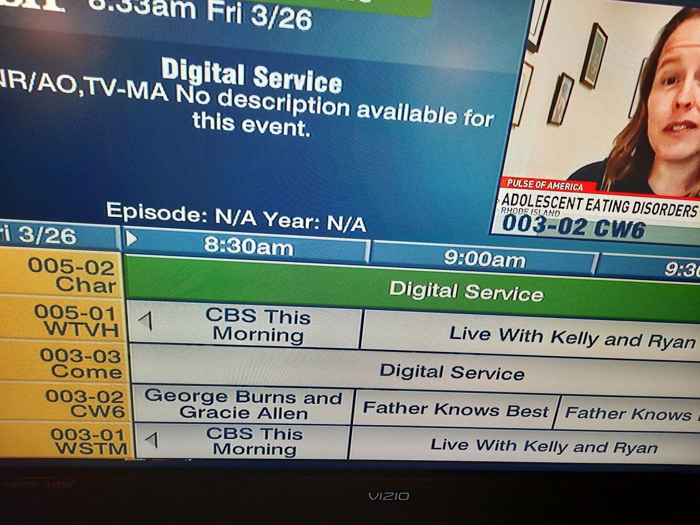

After a required rescan of my locals, NBC3 (WSTM-NBC3) moved frequencies. The guide has CBS5 programs listed on 3, Antenna tv programs on 3.2, which is on WSYR 9.2 and Digital Service on 3.3 5 and 3 are both owned by the same company
. Has anyone seen this before?
i have a VIP722K, I see menu but no tools, or guide update.
On my 722, I could trigger a guide update by doing a switch check. Try that. If that doesn't fill in the blanks, then I suspect Dish's guide did not track that frequency change.

Since the two stations are owned by the same company, I suspect that they are now also sharing the same OTA frequency. Similar guide problems are happening on Dish receivers in cases like this in many markets across the country, including multiple pairs of stations in the market where I live: Cleveland, Ohio.
The problem comes because Dish's OTA EPG mapping is only looking for the TSID (alpha-numeric code being broadcast by the host station, in this case CBS5 apparently) and the subchannel number (-01, -02, etc.). It has no way to distinguish between different primary channel numbers (5 and 3) being broadcast on the same frequency. So, the guide for 5-01 gets mapped to both 5-01 and 3-01 in your case. There is nothing you can do on your end to fix the guide mismatch in cases like this. The solution will require a change in the way Dish does their OTA guide mapping, so that each -01 channel (-02 channel, etc.) gets its own separate guide information, instead of mirroring the same guide info on both sets of channels and subchannels.

So if it is up to Dish nothing will get fixed. Still cant figure out how Antenna tv, which is on 9.2 is showing up on 3.2 on the guide.

I am guessing that with the repack, your channel 3 actually split their signal up across multiple stations. So, like I speculated above, CBS5 is now broadcasting 3.1, while 3.2 is now being broadcast by WSYR. This would cause 3.2 to share the same frequency as 9.2 (and unfortunately, the same guide info as 9.2 on Dish receivers, at least for now).
You can call the station engineer at your local station (any of your affected local stations) to verify this. I would be curious to know if my theory is correct. I can only speculate, based on the behavior being displayed by your receiver's guide.

Welcome to the club of FUBAR Dish OTA guide data. I have been living this nightmare for YEARS and the common thread is that they are sharing the same digital frequency for broadcast. I have no hope of this ever getting fixed, but I will welcome a miracle.
TiVo DVR's are able to provide EXCELLENT OTA program data--well, I mean ACCURATE--program data for ALL stations and all the digital nets, and Dish contracts with TiVo for its EPG data, so the SOURCE (TiVo) has the data, but Dish seems unwilling to integrate it into our EPG's. I suspect it cost MORE MONEY for the FULL OTA EPG data. If anyone knows the REAL reason Dish does not have accurate EPG data for ALL OTA station's digi-nets, then do tell us by all means. I suspect it is MONEY.

The problem is in the way that the Dish receiver maps the guide data stream that it is receiving from the satellite signal. The system was never set up to handle channels with two or more different virtual (the number before the decimal point) channels on the same frequency (the same OTA stream) which may or may not also each have sub-channels that use the same digit after the decimal point.
The mapping does use the PSIP data, although all of the actual guide data being broadcast by the station is stripped out. The Dish receiver is only looking for the TSID (Transport Stream ID) being broadcast by the host station. It then maps the satellite-delivered guide data based on that TSID and the sub-channel number only, without looking at the virtual number before the decimal point. The problem with the frequency-sharing arrangements is that both stations now have the same TSID (since they are part of the same signal) which confuses the Dish receiver's guide data mapping process. So, it finds the host station's TSID and maps that station's guide data to every channel it finds in the guide that happens to share the same TSID and sub-channel number.
Of course, 43.1 is actually a completely different channel than 19.1, and 43.2 is actually a completely different channel than 19.2, etc. However, the Dish receiver has no way of knowing that. It finds 19's TSID (in this example) and maps that guide data to both sets of channels in the guide. The correct guide data for 43 is still being uplinked to the satellite. It is just a matter of changing the mapping (or changing the entire mapping process, or changing the entire OTA guide delivery system) in order to get that guide data to actually show up on the appropriate channel in the guide.
