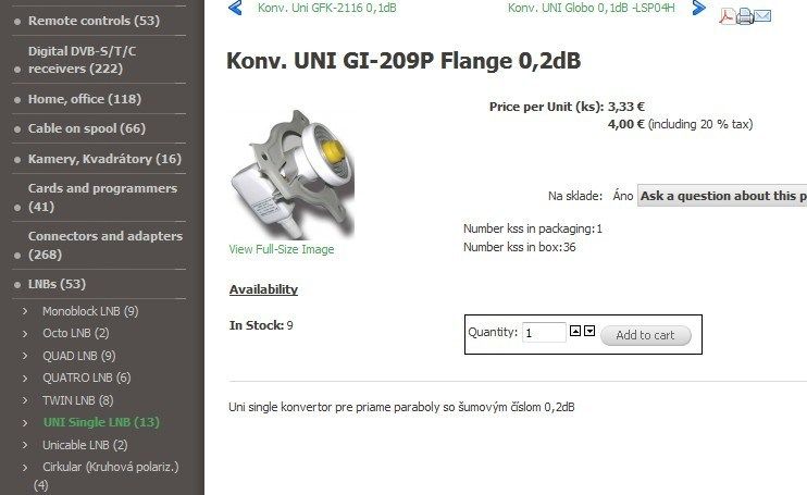

Look for GI-209P, we have them in Europe. I have positiive experience with it. Worth to try
Sent from my HTC Desire 300 using Tapatalk
Also here, much cheaper, but do not know whether they send to US. Screen_38 May. 07 20.52.jpg
Cool, I've placed my order of a few LNBs two Prime Focus and two for my offset dish I hope this two Prime Focus LNBs works because those designed for offset and those C Ku Combos are a waste of money and time.
