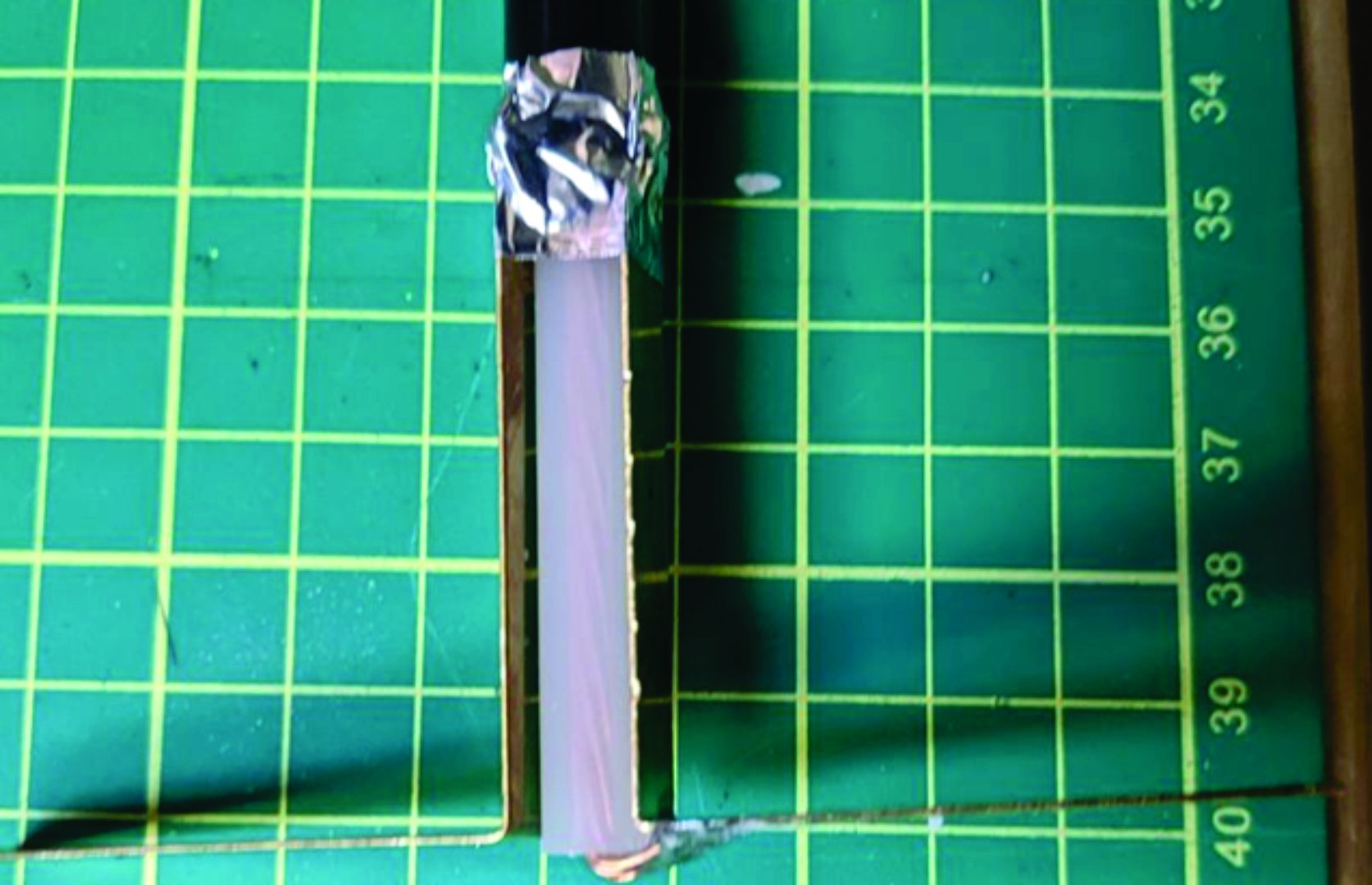

By chance does anyone know the exact name/type of the dipole feed used on the grid/helicone antennas?

But. I didn't read well enough. GOES does use circular polarization. But like the grid, it uses linear also. And so. Even though the photos on RTL-SDR links shows the dipole mod and measurements needed to lower the wifi grid to GOES freqs. Nothing is mentioned on the type of antenna it actually is. I could whistle one up in a half an hour.
Another site I ran by even showed the top reflector dimensions and bend angles. Kicking myself for not bookmarking it and haven't found it it again. In a day my browsing history can get stupid long. Especially on projects.

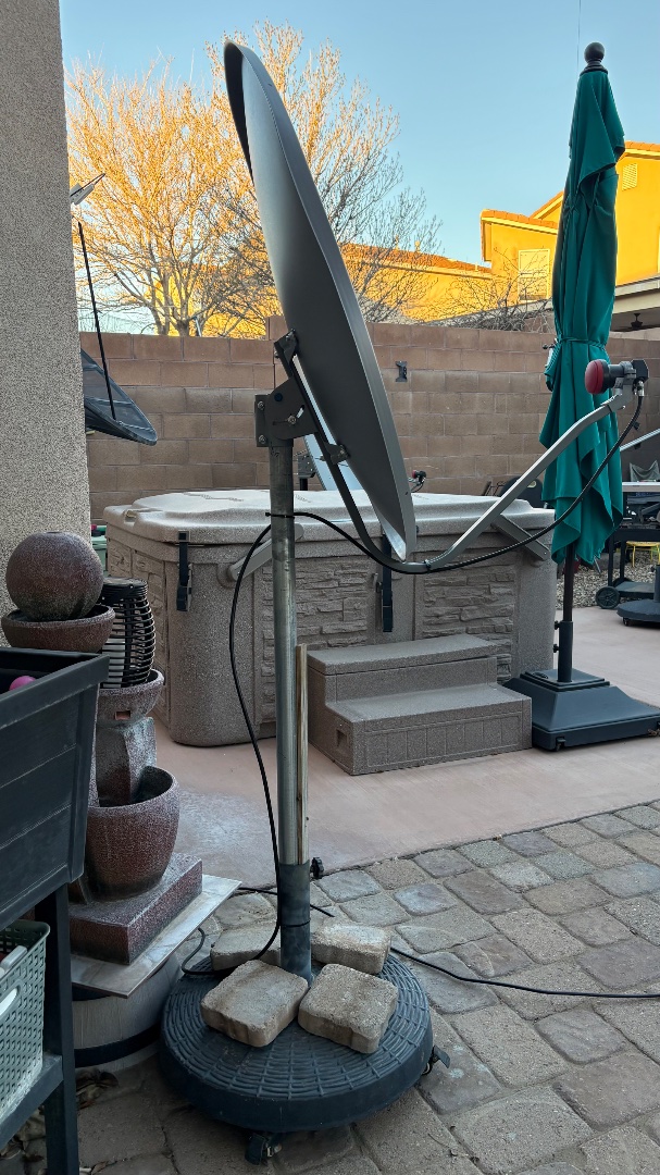

Hey folks, been offline a bit, anything new out here? bit chilly today but got my offset fed dish moved to another "temp" spot and better view thru opening between the trees. Will see how it does once the leaves start sprouting. Got a little it locked on G19 now as well, and got a little better signal from it than my 4 foot one. Now have 2 receivers running, 1 per each dish. I did noticed that when I connected up to the SES2 Sat, all the signals were there again and strong. Wonder why they keep going off line and back on again? Thanks folks.

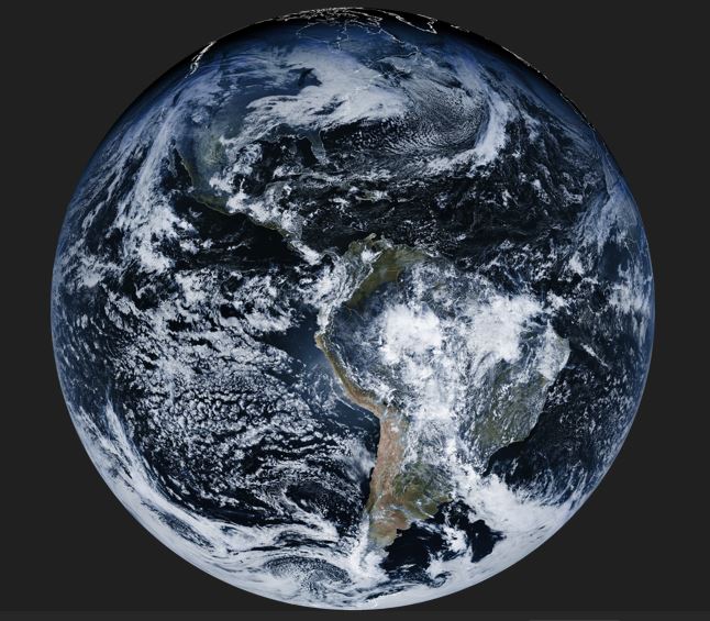

Hey Arlo, nice to see someone trying the GOES Sats too. I tried lots a feeds back long time ago, large dish, etc. Just started back up on them once I realized what you could do with SDR's these days, and some pretty cool Sat programs out there. Now I have a small grid antenna, feed and antenna bought from a vendor, and now get earth images and messages from the GOES Sats. And small dish with same type feed assembly for full Inmarsat reception. I think the feed is linear, there are photos of the inside of it. One of my received images. Frank
