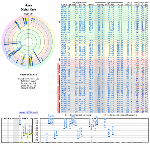

The OTA part is stickier. Using TVFool.com, can you post the PNG image of your radar plot post-transition? If you're close to the towers, there's no reason that you couldn't use an Omni antenna, a distribution amplifier, another 1*8 splitter, and a big bag of diplexers to insert OTA signals into the to-unit RG6. Unfortunately, there's nothing like the old school Dish-compatible multiswitches that could do it for you. Each output of the multiswitch that feeds a unit would need a 3" extension cable, a feed from the 1*8 OTA splitter, into a diplexer, and then up to the unit. In each unit, you'd get the RG6-QS out of the wall, into a diplexer to split the signals, into the separator, and into the 722. It'd be ugly as sin, but it should work just fine. Instead of 3*RG6 cables from the roof to the utility room, you'd need 4, which handily comes on spools, all four conductors bonded together.
Hey, great website. Here you go.
I am wondering if I could use more than one directional antenna and combine the signal... don't know if that would work.

Not sure which OTA channels you're after, but if it's just the ones with LOS according to that plot... you're only 10 miles from them. You could probably get them perfectly with a coat hanger. :)
IIRC, 119 will be replaced mid 2010, and 61.5 at the end of 2010 per the current contract information. Dish just signed the contract to build the new 61.5 sat.
The antenna plot is going to make OTA pretty easy, as it looks like a full compliment of OTA stations are all available in the "green" (very good signal levels) and all from roughly the same direction. I'd probably put up a "batwing" (Winegard GS-2200) and call it good.
