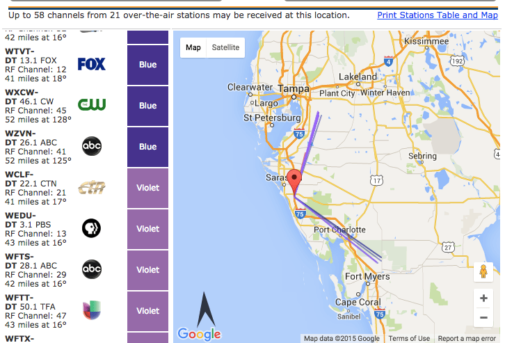

One thing I noticed about your loc is you're kinda half way between Fort Myers and Tampa.
Fort Myers is a UHF only market.
Tampa has PBS CBS NBC & FOX on vhf.
So depending on what the tvfool reports we can go a couple ways. Do you want as many stations as you can get regardless of location or do you just want to get one city's locals?

To connect to five TV's like you want to do, you may want to consider using a distribution amp, much better than using a splitter, especially if it's long runs to the TVs. This is the one I use and it's been really good, I have eight TVs hooked to it. It'll keep the signal input into it at pretty much the same strength to all of the TVs.

Also, tell how much space you have in your attic. You might need a fairly large antenna, since you're some distance from both towers. We need to know how big we can go before it won't fit.
Be aware that you can lose up to 50% of your signal by having the antenna in the attic. Surrounding roofing materials can block signals.
Reactions: Mr Tony
If you tested the outdoor antenna at ground level then that would account for the poor performance as well. It should be on the roof and in the clear without any obstacles in the way. Trees are real bad at UHF.
A 5 way split will require an amp as suggested as well.
