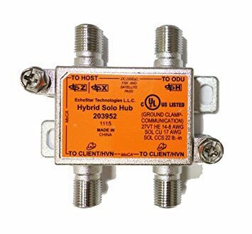

Yes, you can use a splitter to have two clients feed from one line. As far as getting a client line to the basement in the first place, you would usually run a cable from the Solo Hub (the splitter in the attached image, usually outdoors near something to connect a ground wire) but if that is not possible you can install this (Hybrid tap) which will provide a client port if connected behind the Hopper, then for the two Joey runs, Dish recommends this splitter (don't think it matters but Holland is a good brand anyhow).
Another option would be to have the satellite run go into the basement, because the Solo Hub provides a Hopper and two Joey feeds anyway so if its installed there then you would not need additional splitters.
On the image bellow: ODU=Satellite dish, Host=Hopper, Client=Joey(s)
