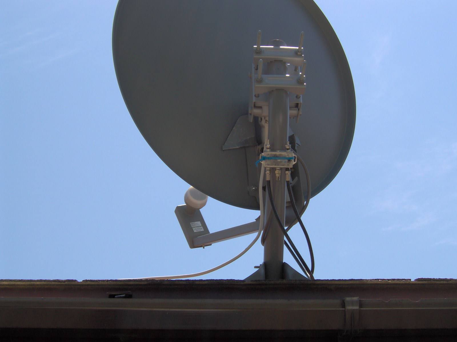

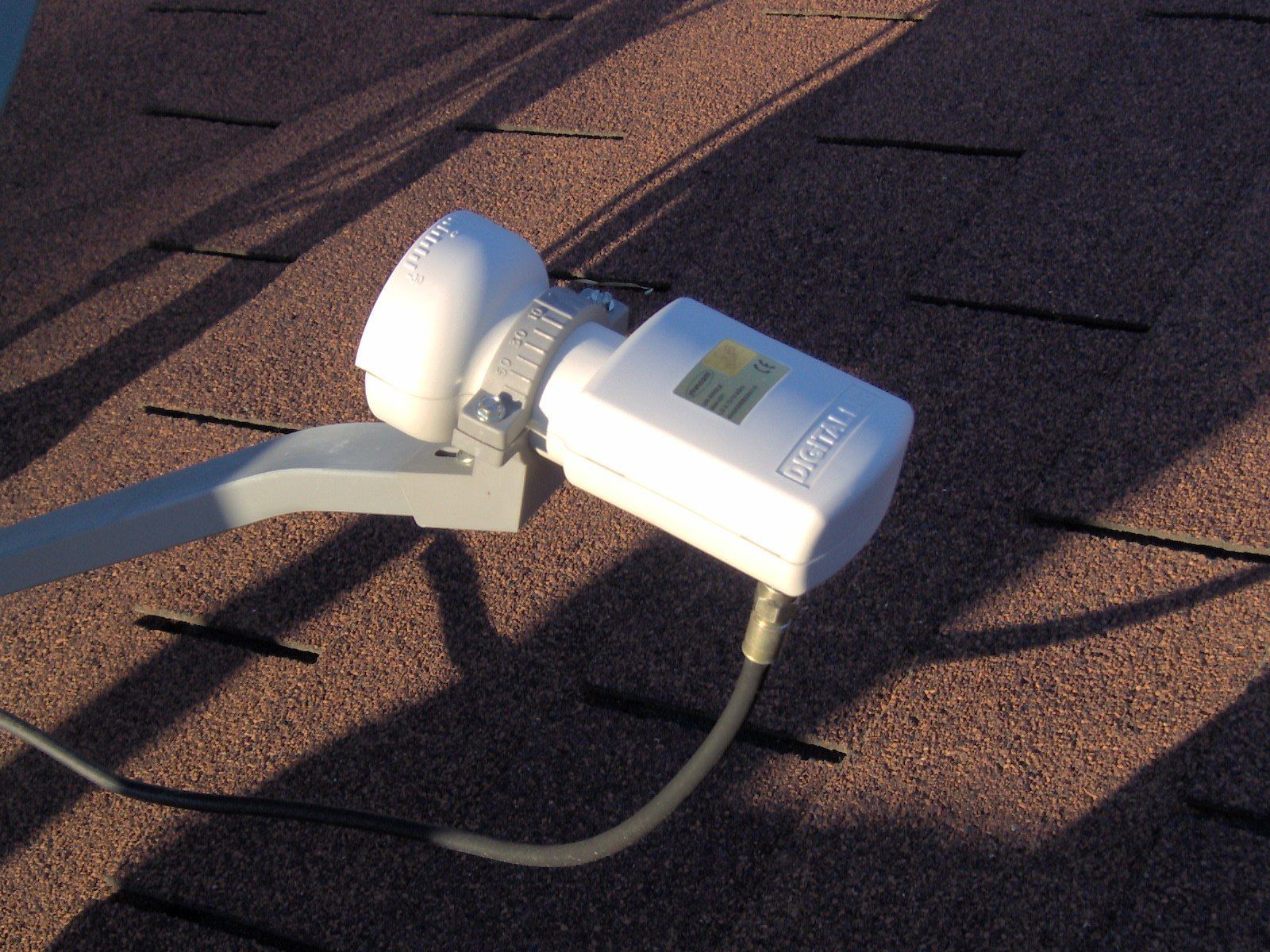

OK, I hooked the new receiver up and did some switch tests and got it running and the first time we did not lose the signal, it was week but we kept it. So far so good, I got a new LNB in the mail and here's were new fun comes in, it is a 'Digital LNBF' and the mount does not fit. The old one had a rectangular mount and the new one has an ovalish mount. Does anybody know if there is some kind of connector available or do I have to get a new arm?
Thanks again for your time and for your patience.
Add on: Meanwhile I learned this is called a d-tube, but how do I get those two together without buying a new dish? And I was looking at signal finders, can somebody recommend a not so expensive one?
Whoops. Sounds like Dish forgets that when you are in Alaska you need the old rectangle LNB's like DirecTV use to use and not the dish "D" ones due to the dish size.
Does the LNB (the existing one you have) slide into the arm of the dish or is there a bracket? see attached pics...1st one is where the LNB slides into the dish arm and the 2nd one there is a bracket.
Unfortunately there "D" style wont fit in the rectangular hole unless you jimmy rig the arm which you probably don't want to do. If you want, I have a bunch of the rectangle LNB's from old projects I've worked on and I can send you a couple of them no charge (just PM me your address). Then you wouldnt have to go through Dish again :)
As for the signal finder, the SF95 is a rather inexpensive ones and work pretty good especially for DBS satellites.

The LNB slides into the arm and I was wondering about the possibility to attach a bracket to the arm but couldn't find anything on websites.

Dish makes an adapter called an " I " adapter that should work as it converts from a square tube to a D tube but the question now is what is the model number of the receiver that they sent you? If its a four digit ( 1000,2700,2800,3000,4000, ect ect ) then the dishpro lnbf wont work nor will the dishpro plus, if its a three digit ( 301,311, 501,508,510 ect ect ) then it will but some of the three digit receivers are dual tuners and you would need two lines depending on the rest of the equipment they sent you.
The I adapter wont work as the larger dishes already have the right focal point. If you add the I adapter now the focal point is off and the signal will drop even on the good transponders.
The I adapter only works on a Dish500 as it is the same length as the Y adapter
If her hubby is skilled with a tape measure, hack saw, and a drill and I've never heard of an Alaskan mountain man that wasnt then he could cut off the same length on the existing arm and drill the holes for the I adapter to go in place but ofcourse thats if they want to risk cutting the arm.
