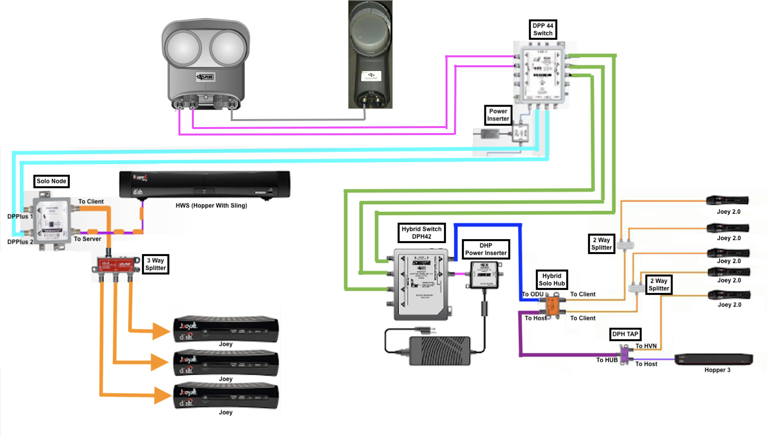

Thanks for the information. Yes twin LNBF (2 hoppers - a sling and a H3 (2) accounts + 5 joyes on one and 3 on older Hopper sling ) I have 2 small dishes (old mx sky TV dishes) (77 & 72) and the channel master 1.8M for 119/110. To be honest my Dish guy here is very $$$ because its a usa dish - he was good but my hopper3 is all new to him...so i like to get the best advise so i can translate and give to him and he doesn't have to do all the trial and error. I don't care where i get the locals from (i put everything on my dvr anyway) for years i got NYC or LA from 119 then the spot beams came on. any information you can give me is a big help. I very much appreciate the time.
The best thing is to aim to CORE birds on eastern arc (61.5°W ^ 72.°W) tell your guy just to aim with a old receiver (Tailgate or VIP 211) the hopper is a receiver that needs a lot of signal and gives tricky levels, he could aim orbital slot per orbital slot and then connect the hopper here's a rough idea of wiring for just one hopper 3 (I will elaborate a bit more on the wiring latter if needed).

I would put port #1 with 61.5°W and port #2 with 72.7°W and port #3 with 77°W (optional).
Now there are several other things I would advice before you calling your tech, please post your levels out of 119°W specially the Spot Beam transponders (1 thru 5) Not the CONUS......
This should work, you also could also use single DP LNBF per orbital slot to use full gain (whole surface) of your (1.8m) off set fed antenna to feed the DPP44:
