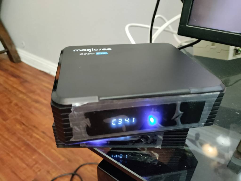

This received does both dvbs2 and atsc and dvr recording although there hard to find I was able to get my hands on another after returning the other one
My issues was with channel 34.1
You can edit the atsc frequency was wondering if it would help me to know wich it operates on

It also has slot for 2.5'" hdd take up to 4tb
But quick question is works almost all channels but someone's get glitchy on some I think I might have the wrong amplifier I have a Europe 220v axing for both universal lnb 22khz compatible with antenna but I'm pretty sure that's the problem since the frequencies might be off

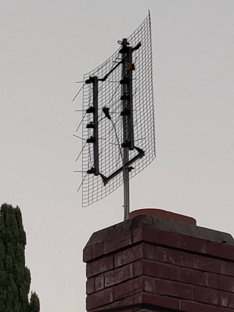

What's if I only have this antenna how would I go about the connections from uhf and vhf
Or do I need a better antennaView attachment 157376
It depends on what channels are available in your area and what frequencies they are on.. That antenna may be sufficient or you might do better with an upgrade. The best thing to do is start a new thread in this forum asking for antenna and preamp recommendations for your situation.
Post up your current equipment, length of run, possible obstacles to reception such as tall trees, hills or mountains, buildings, etc. Also post your rabbitears report from RabbitEars.Info. You will get some good advice from the folks here about what might work best for you. :)
Reactions: Foxbat
The picture looks like the Channel Master CM-4228, very good antenna made in USA before 2000. It covers both UHF and Hi VHF signals. The new RCA preamp with one input should work fine. I had that antenna and a Radio Shack pre-amp feeding a 4-way splitter going to 4 TV at my old home worked great.
