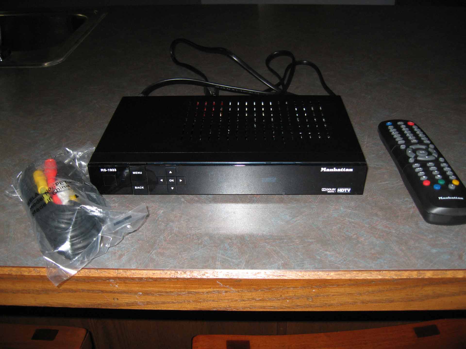

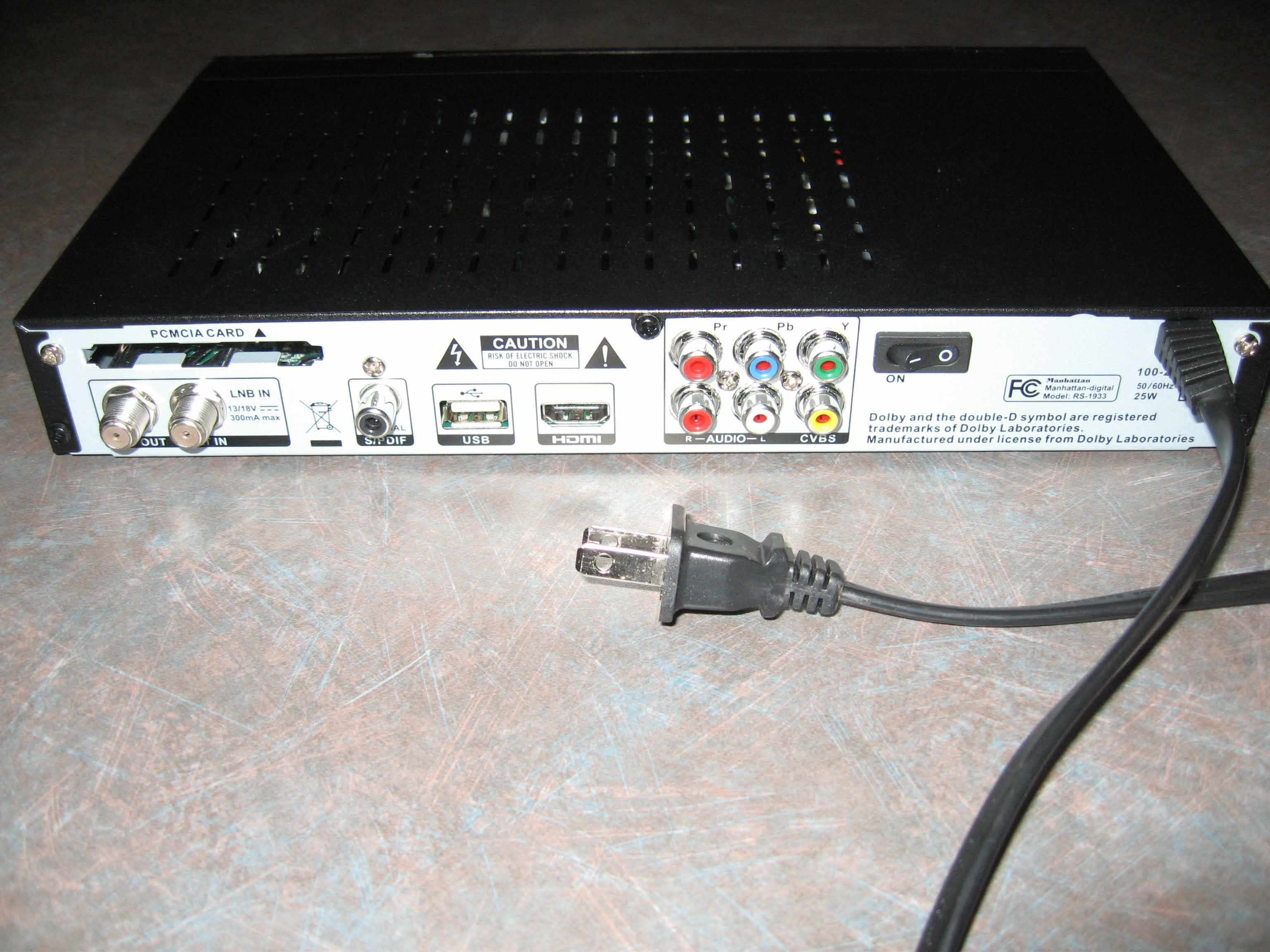

Here are front and back pics of the box. Simple but everything works. I was watching the composite output as well as the HDMI out together after I scanned 125W, and the composite output looked just fine. That's a plus. Blindscan worked fine on 125W, but since I messed up the stb, I won't be scanning anything else right away.
The receiver arrived from Skyvision ( pre-ordered from Mike Kohl) well package. The receivers box was itself in a larger, peanut packed box. Not likely to get shipping damage with this technique. The menu system is very similar to the Openbox S9, so it's easy to follow. The satellite list selection screen is divided into Ku band and C-band sections, Ku band being first. The remote control has a nice feel to it, reminds me of the Coolsat 5000 remote, not too big , not too small. The remote does NOT conflict with my Solomend 800, which is a blessing, so the two of them can be working at the same time ( a problem when I was using the Solomend and an Openbox S9). Overall I'm initially happy, discounting my being an idiot and loading firmware instead of dumping firmware. More to follow eventually. :)
