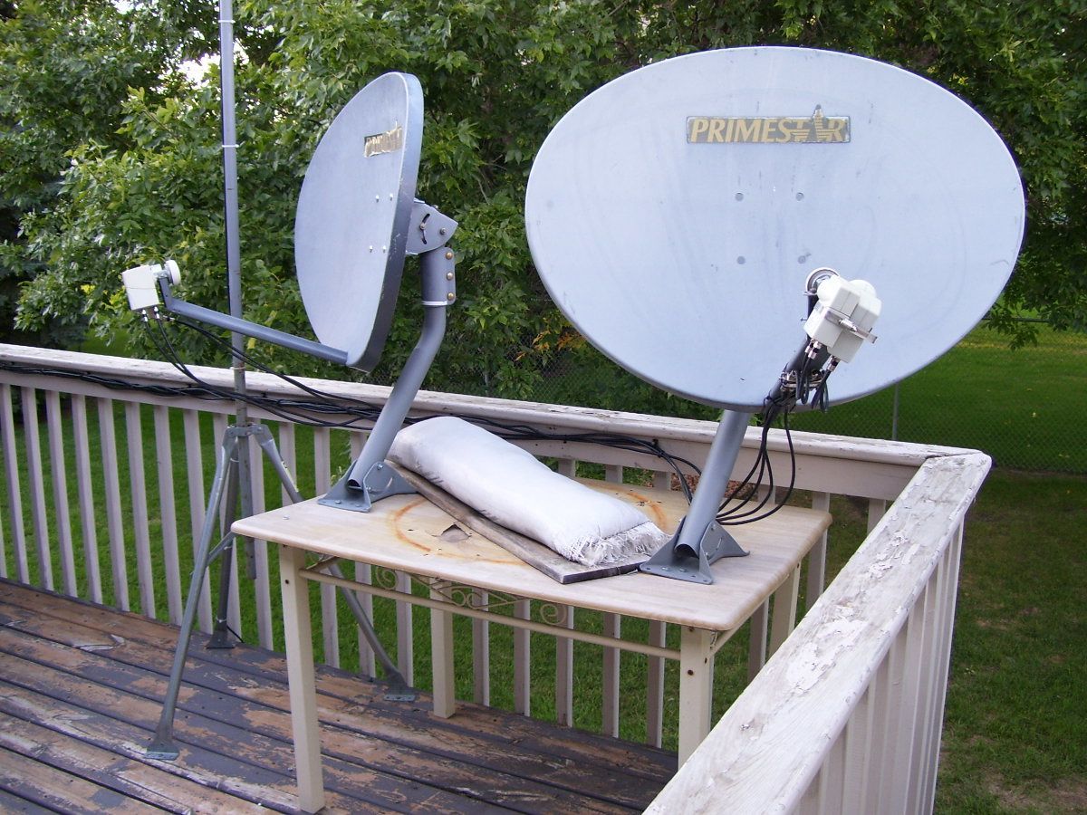

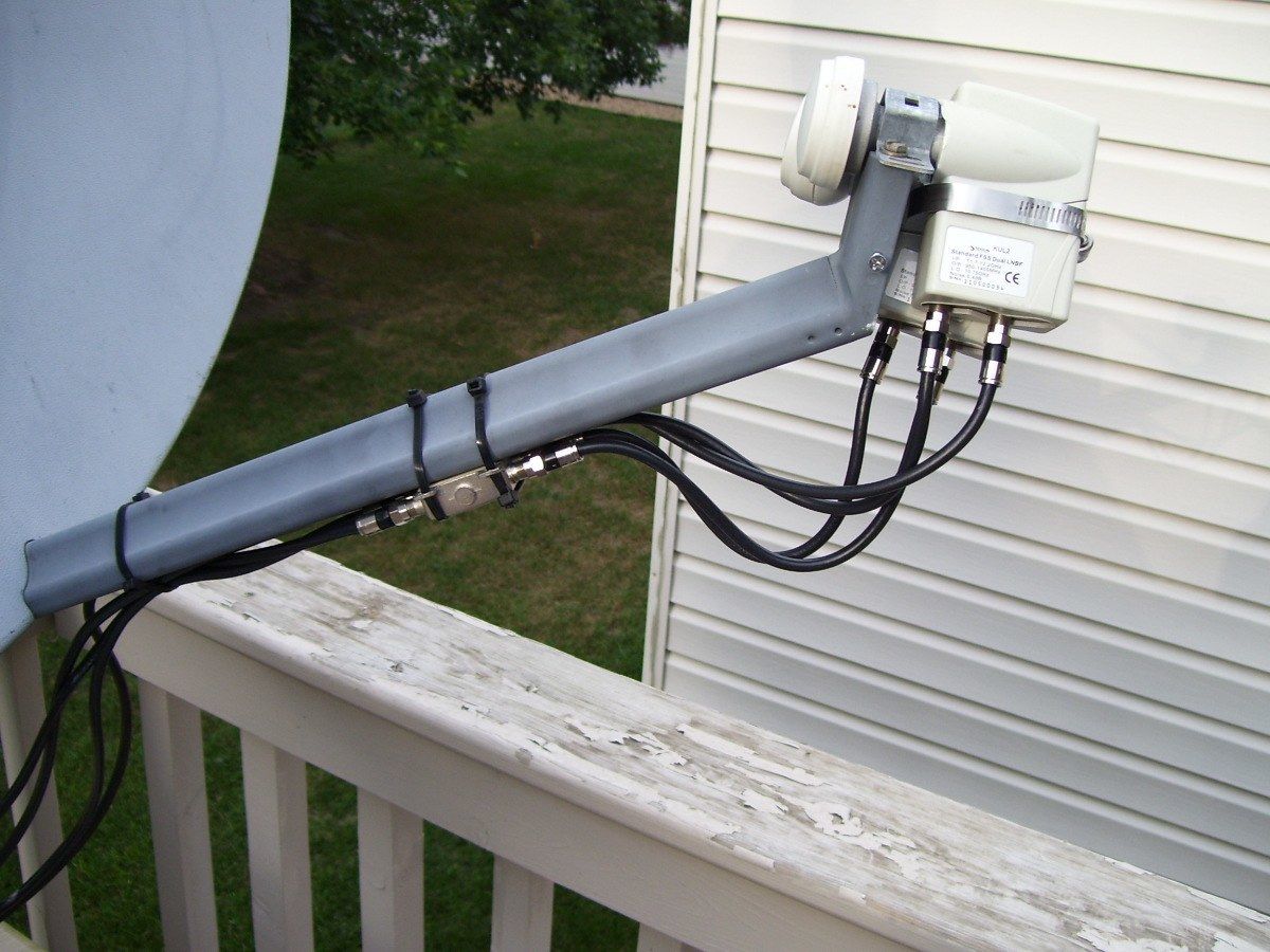

I've been able to do 3 KU LNB's (one on each side) but the drawback is you cant get 4 degree spacing on them...its around 5 degrees so 74/79 can be easily done
I did as a trial 99/105/111.1 Tried to do 97 but the signals were very weak

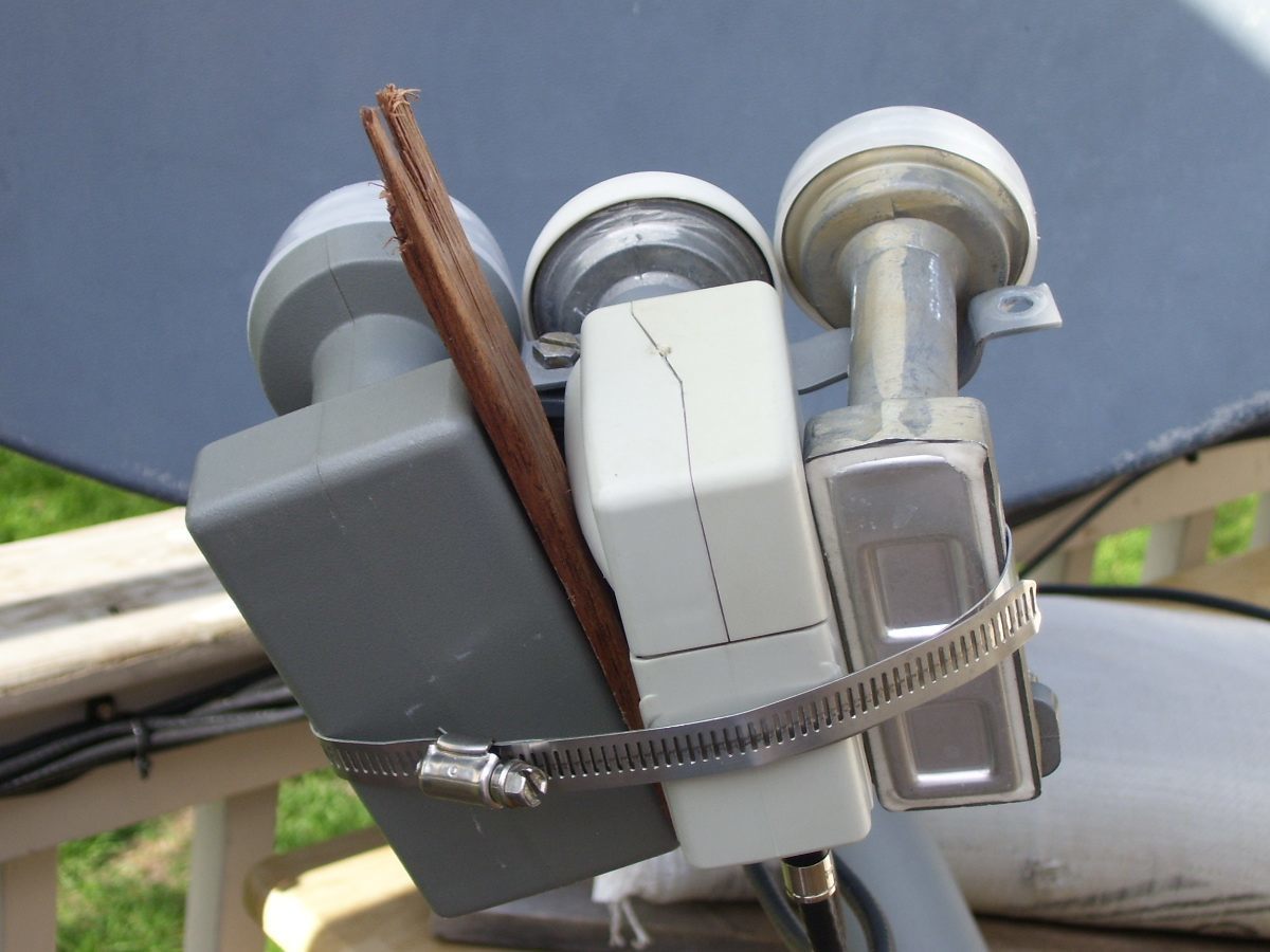

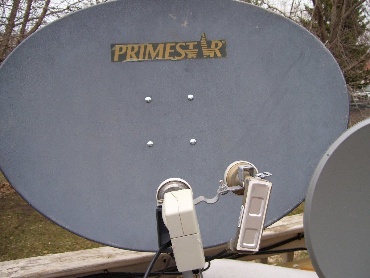

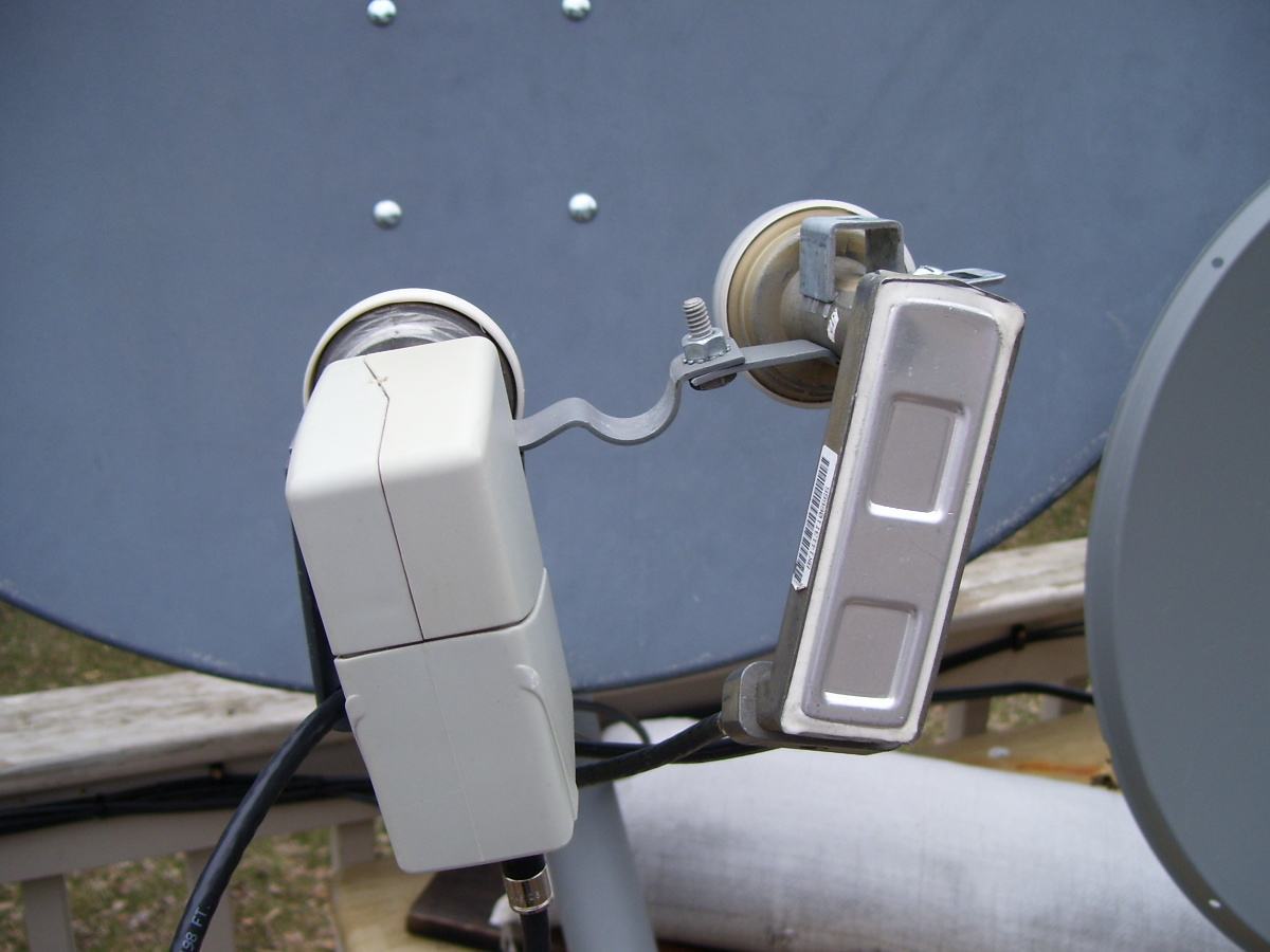

DBS is much easier. Have been able to add a LNB for 119 onto the above. Also have done 110/119/123/129 with no issues (and some hoseclamps
few pics
1st 2 were 74/79
3 & 4 are 107.3/119
5th is 119/123/129

few thoughts:
Also, Linuxman has a current thread about mounting a bunch of LNBs on a six foot offset dish.
It's a lot of reading, but if you'll look through just the pictures, there are many things to learn.
First, if you aim the dish to your true south satellite, then the path of the LNBs forms a fairly straight line, across the dish.
That's for birds quite near to each other; for birds further out, the line of LNBs forms a "U" shape, looking from the front of the dish.
HOWEVER, if you aim the dish OFF your true south satellite, then the line of LNBs forms a diagonal line across the face of the dish.
This is all brought out in words, drawings, and photos in Linuxman's thread.
Second, to get satellites quite close to each other, you need a bunch of factors in your favor:
- choose birds near your true south, not off toward the horizon
- be located closer to the equator than to the pole
- select a dish with a large F/D ratio, offset are best, (long focal length)
- use LNBs with small or narrow horns.
(Iceberg used some bandstacked with tall oval horn, and WescoPC ground down some GeosatPro SL1 LNBFs)
Third, I've assumed you are not looking for DBS satellites.
As Iceberg said, they are very easy on something like an 84e dish.
I believe TheNetBuilder published pictures of an 84e doing 110°-148°.
Can't recall, but I think 123° was in the middle.
