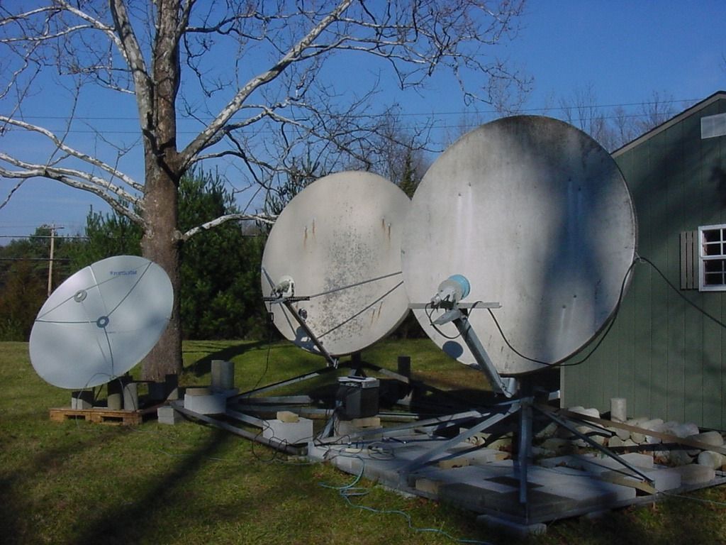

Before the weather turned too cold, I was in the process of experimenting with my second offset 6' Prodelin and my prime focus 6' Fortec Star dishes.
Not too pretty with the NPRM bases, but in time the poles will be in concrete for the Prodelins. The Fortec is currently on the other side of the yard. The hard crusted snow makes it really easy to move on the pallet it's bolted to. These are hidden from view of the neighborhood behind the shed. So they can look ugly for now.
Where did you get your 6' Prodelin dishes from and are they motorized? If so with what?

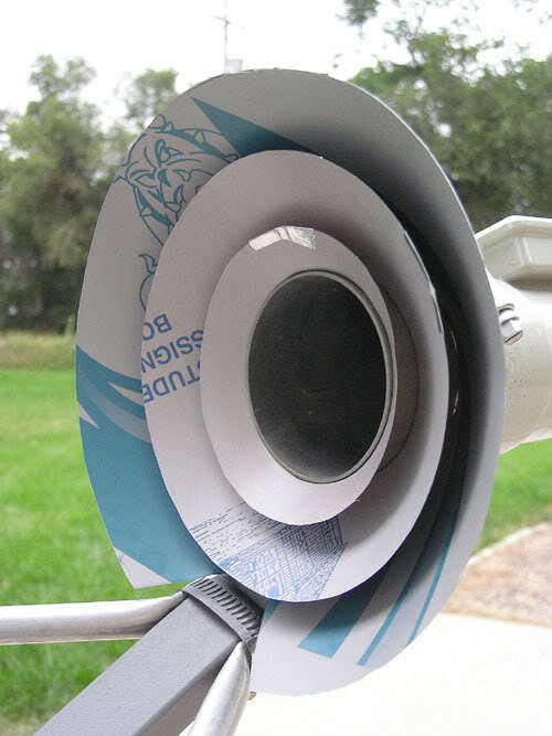

I know many folks have had success with 1.2 meter with certain LNBF's - - - but what I want to try first is may GeoSat Pro 90 and use walrus1957's flat scalar.
This is a cross post of information from walrus1957 from a UK forum. This allow you to make the flat scalar shown which you need if you are using a 90cm or 1 meter dish.
I thought I would post here to make it simpler. I have not done this yet but want to try it very soon.
Picture is by walrus1957
_____________________
Walrus1957 Scalar Cones Construction
Very simple and inexpensive to make.
You can use aluminum roof flashing which costs about $10 USD for a large roll and has a nice springy nature and can be cut with scissors.
90mm ID X 260mm OD outer cone.
90mm ID X 200mm OD middle cone.
90mm ID X 140mm OD inner cone.
From the inner cone space the second and third cones 15mm apart on the slip sleeve.
Wrap the LNBF with a single layer of material 45mm deep to make a slip cylinder to attach the cones to. You can use super glue gel.
The LNBF will move closer to the dish with these cones peaked
_________________________
1. Attach only one ring, makes no differnce if it is the small medium or large ring and mount at very end of the waveguide, quality of 60% signal jumps to 68% and dish is very stable. Moving the dish up/down, right/left and inch doesn't seem to change the signal quality.
2. Mount second ring 10 to 15 mm spacing back of first ring, quality now rises from 60% to roughly 78% and dish is still very stable. Arc alignment for all sats seems spot on. Moving the dish up/down, right/left 1/2 inch doesn't seem to change the signal quality much.
3. Mount all three rings as shown in photo. The 60% quality has now jumped to 94% and dish is now very touchy. Transponders on same satellite may have just a slightly different elevation alignment, and from one satellite to the next the alignment could be just a little bit off. By this I mean you could either set all sats for 85% quality and let go at that or you could using a fixed point dish increase signal to 94%. Also moving the dish 1/2 inch up/down, right/left moves quality from 94% to 0%.
