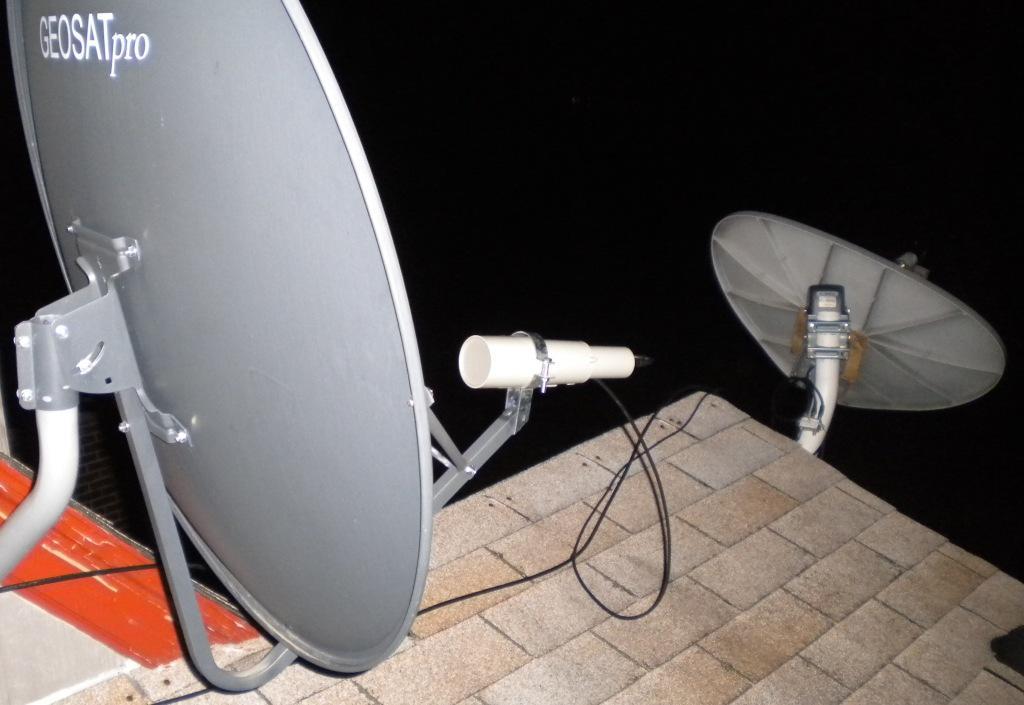

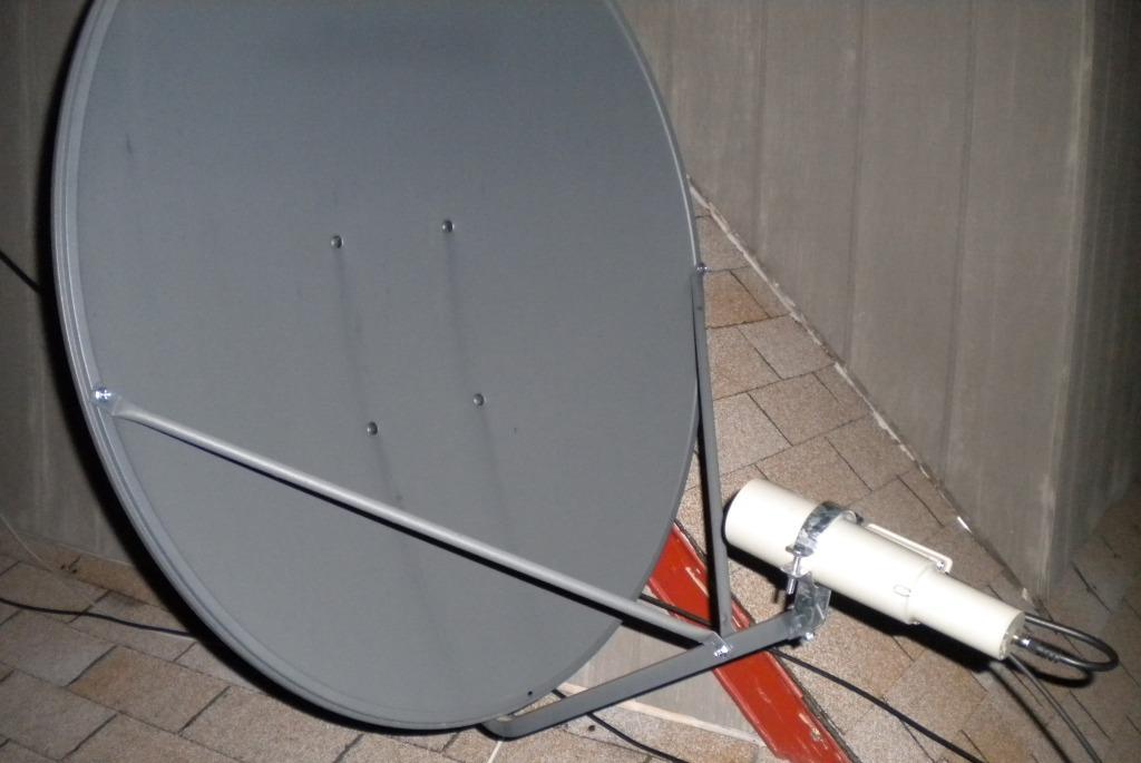

I just got my new combo C and KU Band LNBF (DMX741) from WS International and a C-Band LNBF Bracket for Offset Dish from Satellite AV and could not wait to try them with my GeoSatPro 90.

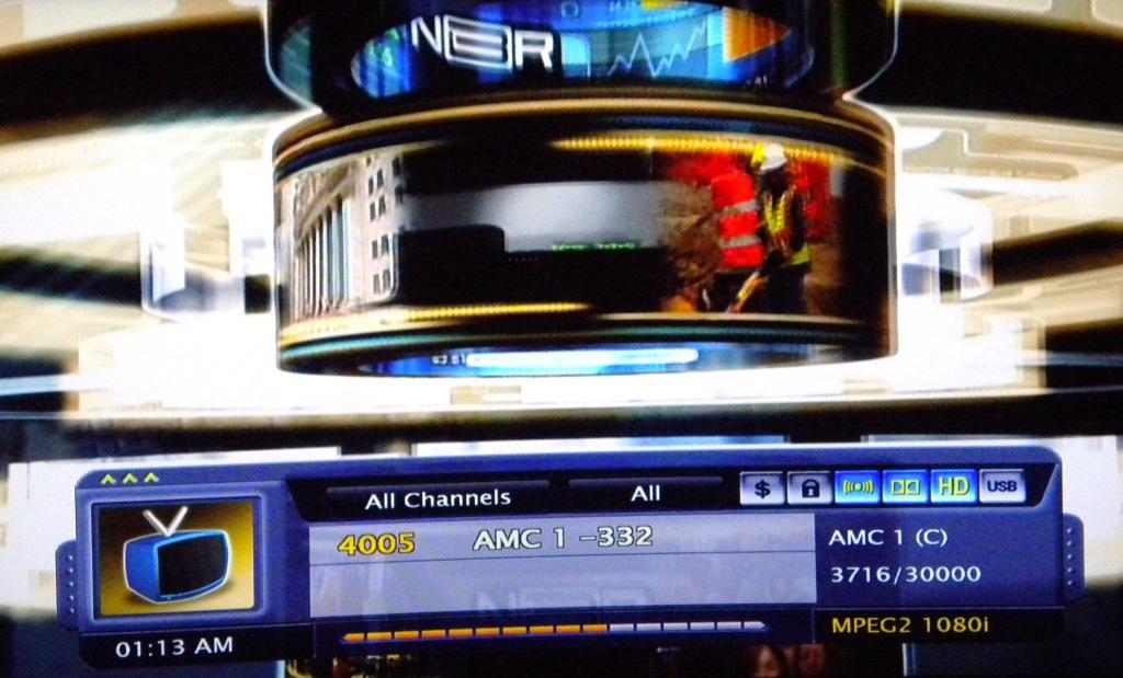

Even though the sun was going down and the wind was blowing very hard I went up on the roof and installed the LNBF. Since the dish was already pointed to 103W I just left it there. I did not really have enough sun light to move to a different satellite. Anyway, I'm already amazed at the results.
After installing the LNBF - - - first scan of 103W I got 12 channels on C-Band and 3 KU channels.
I've included some pictures but will soon post the Signal and Quality.

Appears to be PBS on 103W
I'm getting what appears to be 12 PBS channels from 103W C-Band. Very similar to what is found on 125W KU-Band.
Here is the info
Freq SR POL Signal Quality
3727 4444 H 59 70
3746 14029 H 60 49
3756 30000 V 67 59
3792 4340 V 62 49
3800 4340 V 62 49
3716 30000 V 67 93
I checked Lyngsat and this is not in listed but since it is PBS - - - I hope it is OK to post here.
