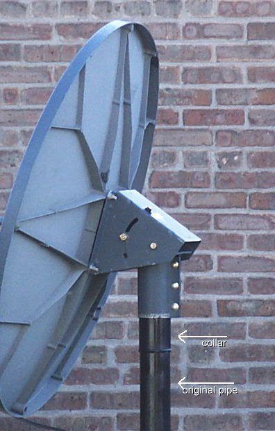

I welded a collar on my pipe with my 90cm Primestar (channel master) to bring it up to 3" that the mount wanted, works well.
Interesting... what kind of pipe was the collar made from?
