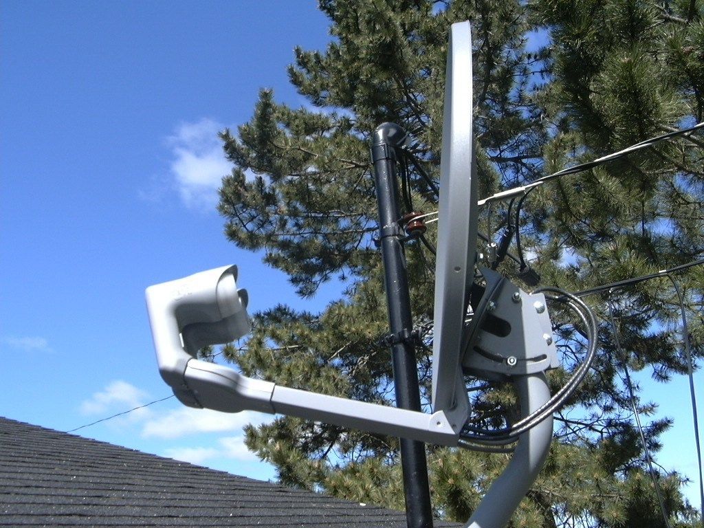

Here you can see my Bell expressvu dish and the unused plate on the roof where I want to mount the third dish. For G10R I think I need a very long vertical pole because of 17 degrees inclination. Does the electrical black pole can cause obstruction of signal from G10R, or will it be too close of the dish to cause problem?
Wait a minute! That tree will be your main problem getting G10R by the looks of the picture! You may have to put the dish way over to where the picture was taken to get any chance to hit G10R. Hard to tell with a picture, worth a try anyway. If it does not work you could always swap dish locations. You don't want any more holes in that roof if you can avoid it!

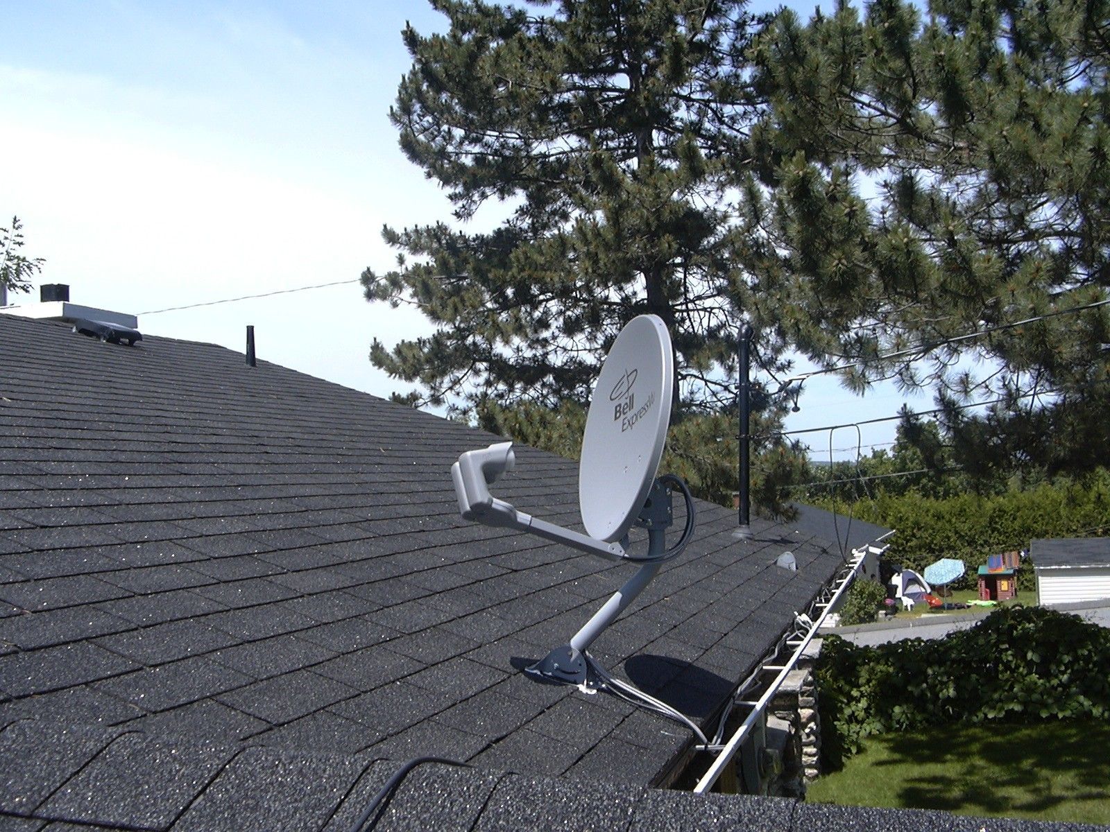

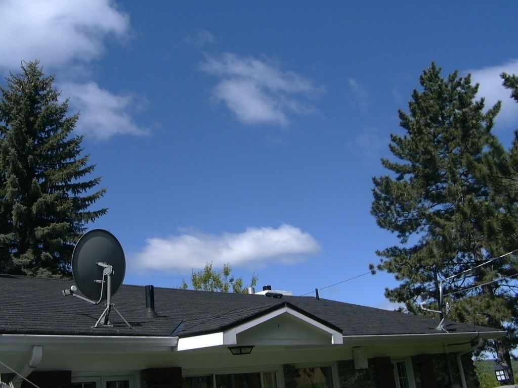

if you could take a couple more pictures (different angles), then we could get a better understanding and can see the clearances and obstacles you have.
I ran a couple numbers and G10 is at 255 azimuth (taking +15 magnetic into consideration)...so the dish aims almost straight east
(I was using Quebec City as a point...if you're a little south the numbers should be the same)
I do not have actually a kodak but here are 2 others photos from last year installation:
1: This was the 91/82 dish (Expressvu) position (now with unused plate) where I want to mount a dish for G10R at 123W...is it too close of the black pole (electrical entry)?
2: a greater view of the back of the house: the dish on the left is on 97W (IA5), also on the left you see the famous pine tree who cause me problem on 91W last spring, with the growing of the branch I dont't think amc3 87W would be possible neither..
Now from what you see, what chance I have for G10R? if needed, it will be possible for me to cut some branches on the pine tree on the right of the picture, but not the one on the left cause it's too high and I should have to pay a "cutter guy" for that. It's also impossible to me to make others holes on the roof...I would be expulse from the house !... :)
