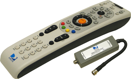

Did the first installer use a Multi-switch!? If so, have the next Tech. check to make sure he's using the right one for the MPEG4 signals, then have him make sure all sats are feed into the proper coax. for each sat. It sounds like the dish is setup properly but the feed is not making it to your receivers. Remember, all 4 coax need to be feed in the Multi-switch if used. Also, check the back of you H20 receiver and make sure the "B Band Converter" is hooked up! This piece look like the old coax connector from the Old NES Nintendo!
Yes, he did install a multi-switch. I believe it is the correct one (after seeing a video of the 5 LNB setup on another site). I'll check the coax feed into the switch (I'm thinking there is only 3 not 4 going in - I'm at work right now, but will check when I get home). The B Band converter is hooked up. Thanks for the reply, as I stated above these guys had no clue..:cool:
Any chance the B Band converter being the cause of the problem?? I remember seing another post where this was the case
Yes, the B Band Converter could be bad but it sounds more like a problem with the multi-switch! Check that first. This dish also have a multi-switch built in, and if your not going to have more than 1 H20 and 3 basic receiver hooked up excluding Tivo's, or any variety of receivers not using more than 4 lines, then the Multi-switch is not needed. For instance, I have 2 H20 hooked up and 1 HDTivo and I didn't need the multi-switch, my receivers are working just fine. So check that out first or as another option for the installer if you don't need it!
