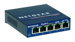

You could put in a 4-port gigabit switch and split the ethernet connection. One output would go to the HIC, another would be the ethernet run to your TV. There isn't a way to get ethernet "out" from the Hopper 3 or its coax feed. So it seems like your best bet is to run an ethernet cable from where the switch would be in your basement up to your living room.
