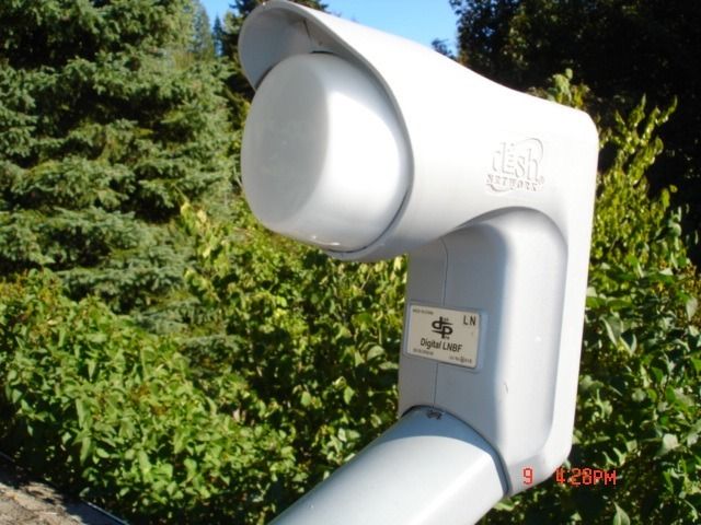

L levibluewa SatelliteGuys Pro Apr 25, 2006 1,150 7 WA, OR, CA Aug 29, 2008 #8 Is this one? they installed it on the 129 dish. Attachments DSC00009.JPG 61.2 KB · Views: 161
