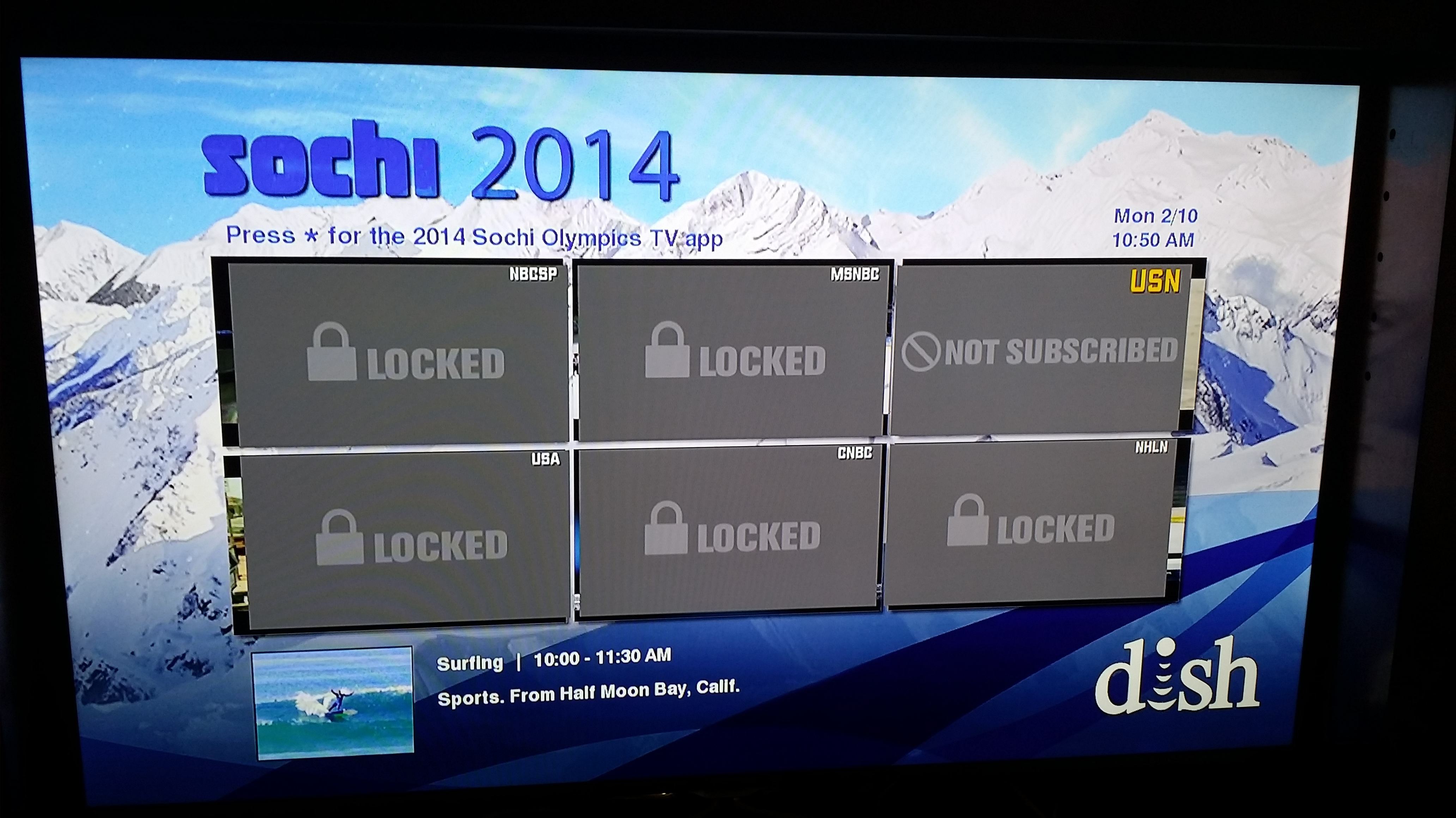

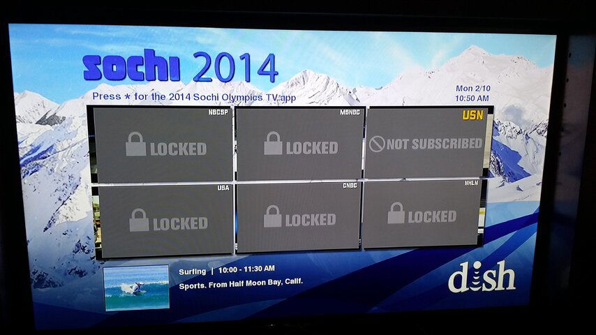

I unplugged the Hopper (no OTA module installed) to see if it would reset and release the channels on 100 but the channels remain locked?
I had this problem with the Locked channels. It's because the Mosaic is drawing content from your SD channels, and if you have the SD versions of those channels locked in the Parental Controls, you'll see this. You need to unlock the SD versions of those channels. When you do click one of those channels, it will tune the HD version, so that's good.
