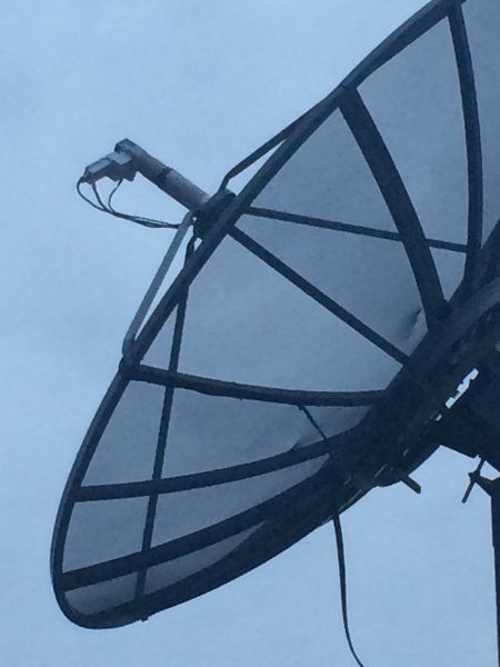

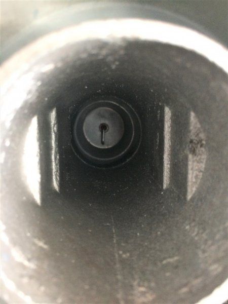

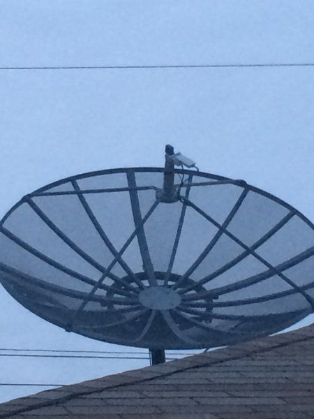

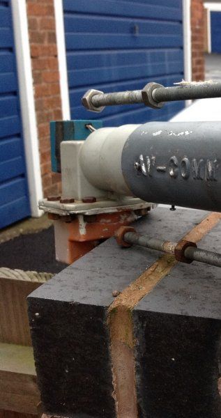

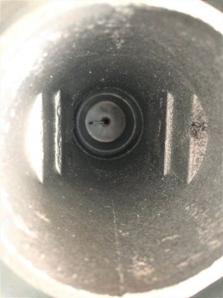

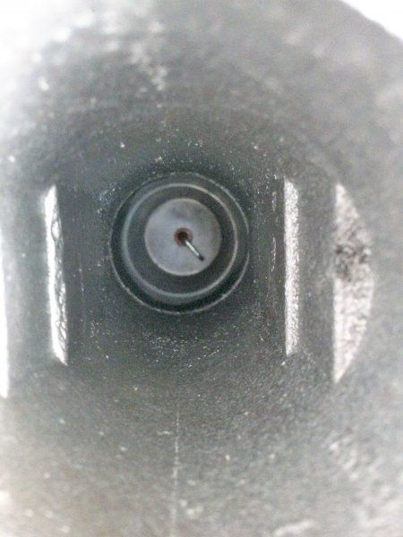

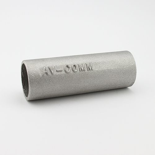

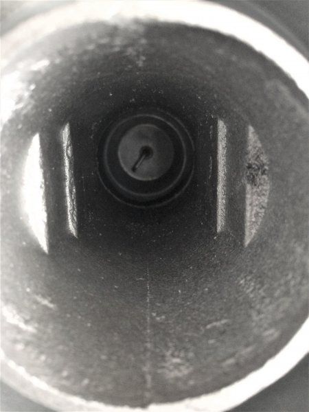

Have not posted here for a while but in response to circular polarization, i made my own feed using a Chaparral Polarotor and Av-Comm circular polarizer barrel purchased from manufacturer in Australia i am here in the states using a 7 1/2ft Winegard Quadstar dish getting decent reception on all circular polarizations using a Titanium ASC1 to set skew positions with polarizer it works wonderful with very little signal loss on linear polarizations its a lot better than using the Chaparral Corotor international feed no dielectric plate in the middle of the oppening.I have recently acquired a 10ft Winegard Quadstar which i will be putting up this summer i will be using it with this feed.I just had to machine the barrel on the inside to fit the Polarotor and the front outside to fit Chaparral scalar ring,here are some pictures of my setup.
Av-COMM barrel
Polarotor inserted into barrel
Mounted on dish

Setting on ASC1 Vertical +45

Setting on ASC1 Horizontal -45

Setting on ASC1 LHC Horizontal +90
